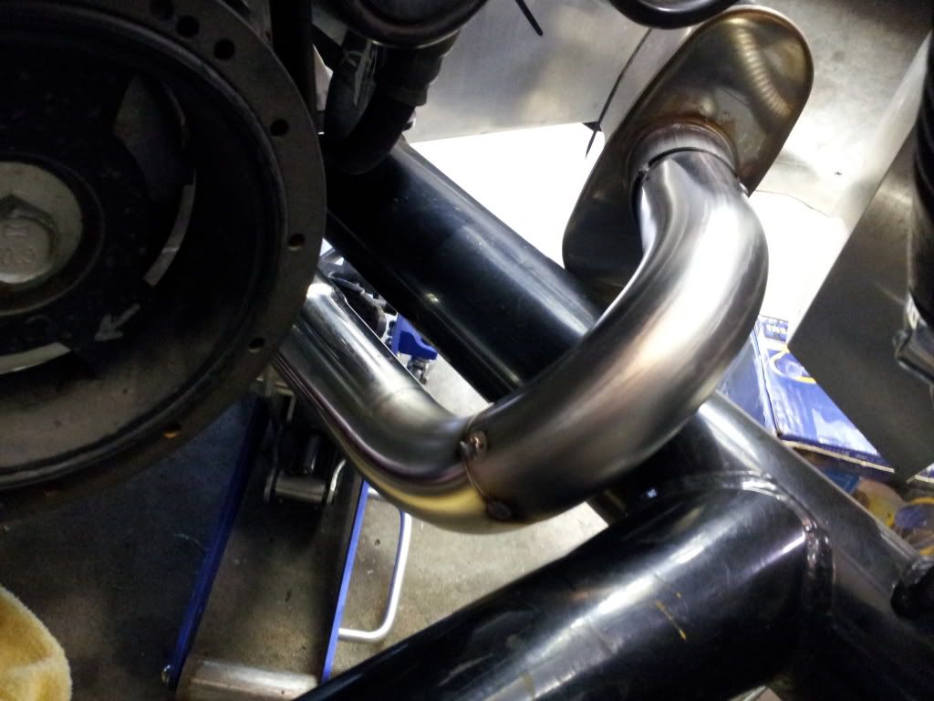

John it is not coming along at all. I am embarrassed to admit this, but I failed to research the rule book well enough. I was reading through the SCCA rules on another matter and re-read the XP exhaust rules which have no restrictions......except for the fine print that says to comply with the safety inspection. I jumped to that section and found the the exhaust has to exit behind the driver, or out the side. This ruined my whole day bigtime!!!!! So out came the saw and I am currently working on plan B and have figured out a plan C just in case.
Perry thanks for the advice. Russ and Hank I fully understand the true artwork you guys are capable of. Thanks for the cudos even though my build goes against the grain.
Time to go weld some stainless!!!!

New exhaust pics:
