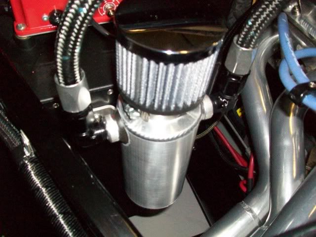

I finally got around to installing a breather tank. The little "Ford Racing" breathers just weren't cutting it. I used billet PVC style valve cover breathers from Jeg's that I took apart and gutted the PVC valve internals. I used -8 Pro Classic lines from the breathers to the tank.
Much better now!

Explain why you felt the breathers wern't cutting it. What problems did you encounter?

Inside a running engine, a small internal pressure is produced within the crankcase. This pressure is generally caused by a small leakage of combustion gasses past the piston rings, and this is known as blow-by. If this pressure is not released, the subsequent build up can cause gaskets & seals to fail, creating engine oil leaks.
Take one of your Ford Racing breathers and turn it upside down. You'll see a very small opening with just a folded flap. They aren't very effecient and don't flow much. Also, oil collects inside them then runs down over your nice polished valve covers, etc. I run a supercharger and allot more cylinder pressure.
In a standard system it vents back to the air filter, any oil expelled may be drawn back into the engine & burned. Burning oil inside a high performance engine is not recommended, and can often lead to detonation. The detonation can lead to deterioration of the piston rings which in turn will increase blow-by. The increase in blow-by will in turn make the engine expel more oil into the air filter; a vicious circle! Also, as wear occurs inside the engine due to use, piston ring blow by will increase further, again putting additional strain on the breather system.
Additional oil can be forced out of the engine due to oil surge. The forces created under hard acceleration, braking, and cornering, move the oil around the inside of the engine. A significant quantity of oil can then be forced out of the engine via the crankcase breathers.
Hope this helps....

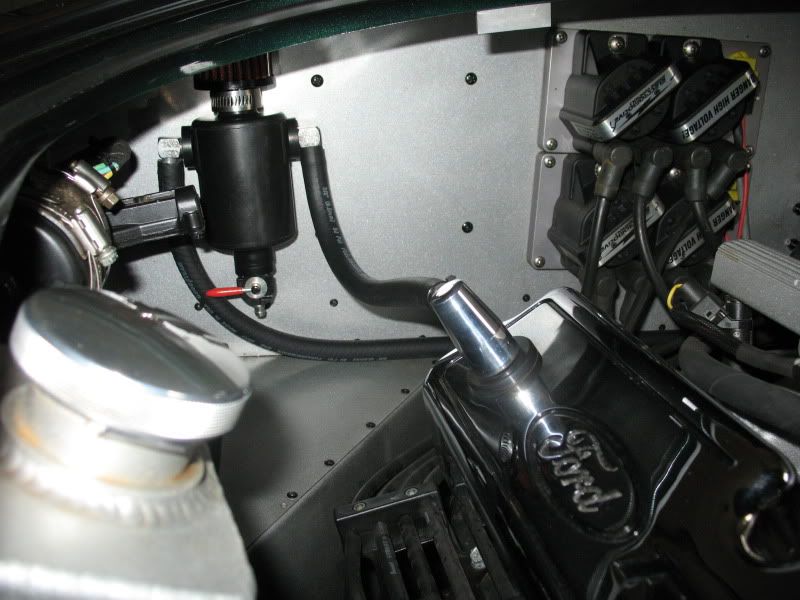

THis is on my roadster, but I had the very same problem...and came up with the same solution.

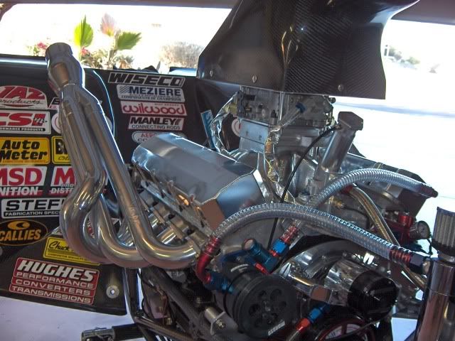

What’s your comment based on? I would agree in a full racing application but not so much in a street application. The – 8 lines, in my application, flow enough gas / air. Pressure is driven by windage which is primarily caused the pistons. A piston is basically an upside down bucket. Right? If you know much pressure is being created you can perform a basic Air Flow calculation and actually determine how much flow is needed. All engines make and will have some crankshaft pressure. Plus, this will vary from engine to engine, ring tension, etc.
You build race engines. I also build race engines and I race professionally. I also have a real job as a engineer at the world’s largest nuclear power plant. Here is picture of my dragster with my 598” Chevy. I run SC, Top Dragster and I currently hold the Top Comp championship in Az. I’ve also raced in the Comp Eliminator class with other dragsters that I owned and built. You would have to agree that this is the toughest class to race in.
In a racing application, such like NHRA drag racing, most basically use sort of a pan evacuation system to lower the pressure inside the oil pan and crankcase. This allows the use of low tension oil rings for increased performance, improves oil control, and reduces leakage past seals and gaskets. Drag racing pan evacuation systems use both intake manifold vacuum and exhaust pulses in the header collector to evacuate the crankcase. I’m surprised that you aren’t running a vacuum pump on your large engines.
The above still works but most, now, most racers use a belt driven vacuum pump to pull vacuum / air. Here’s a picture showing my set up with -12 lines from the valve cover to the pump and tank. On the dnyo, with this basic pump set to only 10" we made 12 extra horsepower. We also run a vacuum relief valve on the valve cover to control how much vacuum we pull. Plus, I made allot more than 614 with this engine.

How does the catch can drain? Manually or does it go to the oil pan somehow?

I'd like to kow how the can drains too. BTW, great thread.

The moroso breather can I used has a petcock on the bottom of the can.

I used 8AN bulkhead fittings trimmed to clear the valve cover baffles. Pushed the fitting into the grommet with some silicone to prevent leaks.

Could the drain line be plumbed back to the pan?

Even given midlife's response, you can drain back to the pan, and it's not necessarily a bad thing to do, as any "Heavy" materials will most likely not remain airborne long enough to travel the distance. I would suggest a drain back through the fuel pump filler plate, if using a EFI system, no incursion into the pan, and relatively easy to engineer. You would also want to have a vent exiting the fuel pump cover, to relieve pressure that would other wise try to push oil to the catch can. The vent would have to be on the scale of a -6 or -8. and the return a -4 or -6, dependent on the vent size.
