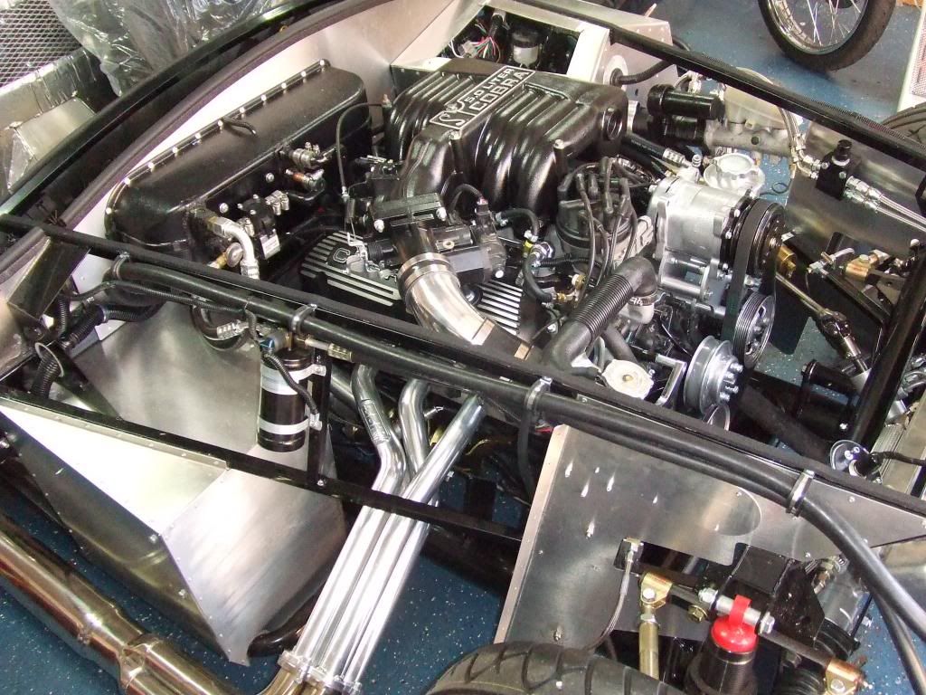

I did all the work last night through the access panel. Here is a pic of mine, you can look at the top and see the white plastic reservoir for the clutch. All I did was remove the nuts for the reservoir mount, the two for the MC mounting, the braided hose to at the output, and the smaller pin. I pull the MC out with reservoir and U shaped bracket attached. Noted the thread length to give me a reference when I screwed onto the new MC. Getting the Clutch pedal out will be a struggle due to the space constraints.

Thanks, I just need the aluminum block to rethread it. I'll open up my access hole and give it another shot. It just seemed to me that even with a bigger access hole I would still have issues fishing out the aluminum block. Worth a shot though!

Well that worked, you just can't see anything you're doing. I recommend an access hole. A little different angle can help.
