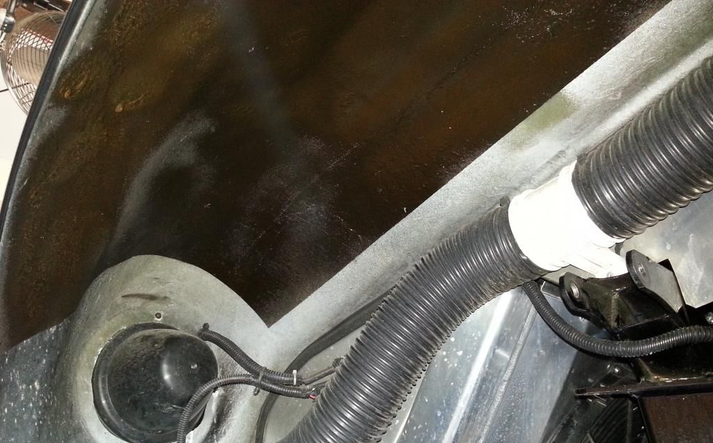

Duplicolor bedliner ....
Not a spray-on, but works very well.
Took my roadster out yesterday ... and rolled it over
