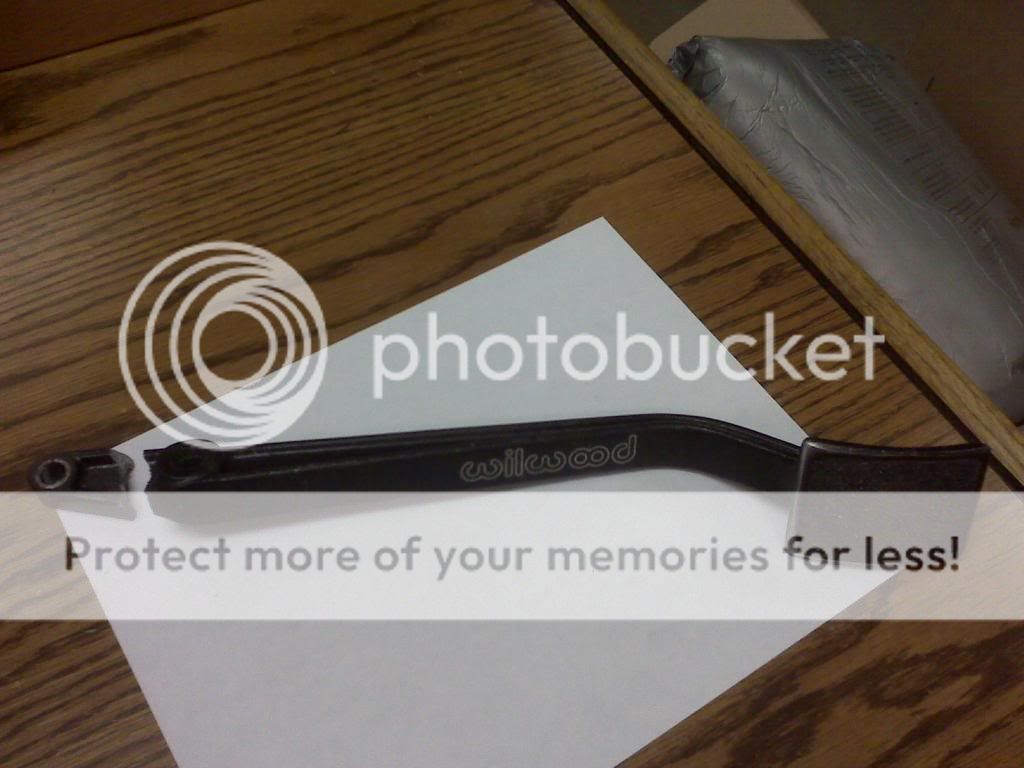

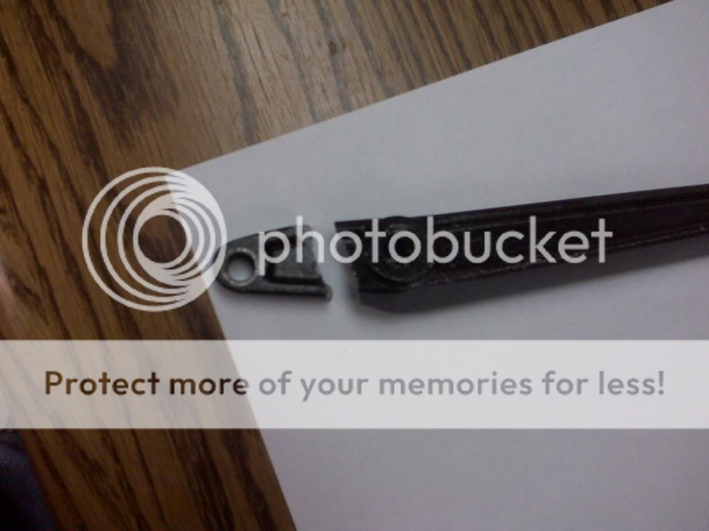

Originally Posted by Michael Everson View Post
I have a customers car here now with a wilwood pedal box. It has under 2000 miles on it. The clutch pedal creaks and sticks so bad, its hard to modulate it. I know its only a matter of time before something fails. Not sure the brace will help because of all the side load on the pivot pin.
I am going to reccomend to him to convert to a hydraulic clutch. What a pain that will be on a finished car. This car has a removeable foot box cover, and it was still nearly impossible to work in there. Cant imagine trying to get that snap ring off when you cant see it.
My clutch pedal started creaking or squeaking after about 1000 miles. It sounded pretty bad and had me worried. I sprayed some lube on the pivot shaft and the noise went away. I didn't lube it when I put it together. I wonder if your customer lubed it during the build.
It appears to me the new part will remove the twisting action from the pedal and stop the pedal from breaking. It won't do much for the wear the pivot pin and mount that may occur over time. There really should be some bushings for this area. This best way to solve this problem is the hydraulic system as you suggested, but I'm going to try the Factory Five fix for now and keep the pin lubed.
Mark III complete kit ordered 12/03/2007, received #6351 1/22/2008 Homemade mods: driver footbox extension with deadpedal and dimmer switch, widened passenger footbox, brake reservoir mounting bracket, under trunk storage box, custom dash and dash extension, heater forward box, custom glove box, under dash switch panel, Explorer motor carb conversion, first start 7/10/2010, paint by Performance Automotive 11/20/2010-5/7/2011, Graduated 11/22/2011

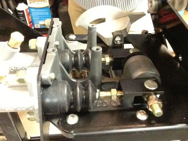

Just finished installing the "quadrant stabilizing" kit. Took about 2.5 hours including relocating my clutch safety switch. I did get lucky in that the snap ring on the quadrant shaft was missing - probably broke off, so I didn't have to fight getting it off. The new snap ring went on fairly easily once I positioned myself under the dash (at 66, that's a chore). Most of the work was done alone; however, having my son help hold wrenches in place helped and probably saved some time. The quadrant no longer is solidly attached to the top of the clutch pedal (previously a long bolt and spacer. The pedal pushes against the new bracket which is attached to the quadrant. This should help keep the pedal arm from twisting with any side load on the quadrant. Anyway, good luck to those who make the change. I think Mike Everson's opinion that the side load is still an issue is true; however, it should have no impact on the pedal. BUt it does raise questions about the pivot shaft. Haven't heard of any of those breaking, yet.
PM me if you have any questions or ask on the forum. I check it a couple of times a day.

Ok here is an interesting one. I just bought an unfinished MK4 and the pedals are the same as my MK3 that I just received the fix for. I called FFR to get the fix for the MK4 and they told me they are sending the fix out because 4 customers had their pedals break because of racing (stiff) clutches. They have or will send out 1500 kits before they are through. They said, "go to the previous owner to get him to forward it to me when he receives it"...
Maybe when I install the pedals I will post a pic of the completed fix.

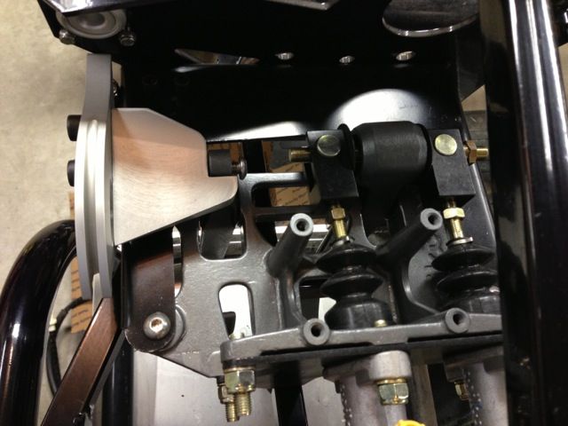

I just finished the fix on my MK4 and installed the pedal box. Those who have completed this fix, does it limit the clutch movement more than before the fix? It looks like the clutch limits are tighter and the stop FFR provides (the bolt through the bracket) is not needed anymore. I had to file the aluminum piece down a bit because I couldn't get the clutch screw started. Anyone else have that problem?

To me
this clutch fix does not fix the problem, the pressure is still where the arrows pointed. When you have a stiff clutch, like i do, there is alot of sideways pressure applied to the top of the peddle arm and thats a problem! In my opinion, all this fix does is go from 1 long bolt to 3 shorter bolts. It does'nt lessen the twisting force applied to the top of the peddle, which is THE problem!
