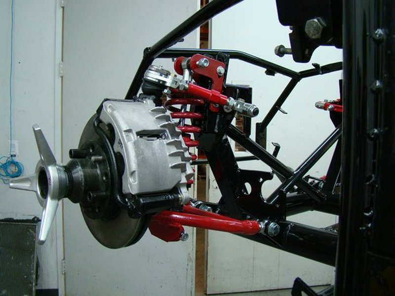

i finally found a good picture. my upper control arms are the gold ones and they don't look like that. do i need to buy new ones?

No your gold UCAs will be fine. An overview:
Initially you will be removing everything except the upper control arm. So you will need a pickle fork to seperate the upper balljoint from the spindle. Like this one;
16" Tie Rod Separator
This will usually destroy the rubber boot so be sure to order a spare boot. At this point you have just the UCA there, so you can install the UCA mounting pieces that come w/ the SAI mod and move the UCA to it's new position. I would then install the new FFR LCA and connect it to the bottom of the coilover. Then install the SAI adapter pieces to the spindles while they are on the workbench. If you have a big vise to clamp them in you can toque the big bolts or you can torque them after the spindle is attached to both control arms.I would also trial fit the calipers to the spindles as there may be a tight fit which may mean you need to put the big bolts on in the other direction. Be sure to get familiar w/ the spindles and the SAI adapters since both have a left and a right version. Think through the whole procedure before you attach the spindle to the control arms cause if you need to remove it, you will ruin your new balljoint boots.
SAI=steering axis inclination. this is a line drawn thru the upper and lower balljoints looked at from a front view. Similiar to caster is the same line but looked at from a side view. The end result of the SAI mod is that the entire UCA and upper balljoint is moved outward. It will actually be sitting inside your wheel.
I would talk to Gordon about the front brakes. Maybe you don't want his largest setup. Talk about getting proper front to rear balance w/ the master cylinder you just installed. Since you don't have dual master cylinders w/ a balance bar, matching the calipers is critical.

Tom: i have the four hole brackets from an early MK3, but are you saying i also need to buy new spindle adapter brackets? i thought the complete kit from Whitby's includes a part that replaces that.
everything in the photos are black, so it's hard to tell.
what am i looking at here? it seems to be the '95 spindle, and part from Whitby's only.

Eddie, what Craig said, forgot you were going to the SAI mod.
As far as pickle forks, I've done this a few times and almost never had success with the fork tool. And for messing up the nut, its a fair chance to dork it up if you don't hit it straight. But a straight, good, blow and it should pop the first hit. I got this advice from a long time mustang enthusiast/dismantler and it works for me.
Tom
FFR 4040 MKII, IRS, 5.0 w/Cam, Super S pipes, March pulleys, Levy Super Alloy T5, Aluminum Flywheel, Ram clutch, 3.27 LSD, Cobra front brakes, Cobra R wheels, double hoops, driver FB mod, Kirkey Vintage 41 w/heaters, Tunnel mounted BMW E-brake handle, custom shifter/brake and cubby bezels, Mercedes premium carpet.
If you didn't build it, you can't brag about it. Just sayin'.
http://www.ffcars.com/forums/17-fact...11-2012-a.html
h82crash is offline   Reply With Quote
Old 10-09-2012, 08:07 PM   #20 (permalink)
*** CAD Librarian ***
Posts: 9,620
okay dudes! it looks like i now have all the info i wanted in one place, and i got the magic number of about $3000. (and Nitto NT-05's have already been budgeted for 2013.)
Jeff K: i am just a beginner driver, and i have crummy Sumimotos, so my oversteer/understeer was directly related to the PSI i had when experimenting at autocross. it was amazing how ±1 psi would change oversteer to understeer (same psi on all fours) but that's another subject.
i suppose the swaybar can be added later without having to pay for alignment again. i am absolutely positive that Gordon's 5-link upgrade keeps the rear of the car level when turning hard, and the overall car more level when turning hard.

Originally Posted by KEITH T. View Post
Eddie take a good chisel and big hammer and smack the gear for the ABS, wright on the teeth as if the chisel were a set of gears meshing together. You might have to rotate it 90* and hit it again it will split in two pieces. NO more ugly gear to look at.
NO NO NO, just leave them on, you may want to run ABS in the future.

Jeff K: i am just a beginner driver, and i have crummy Sumimotos, so my oversteer/understeer was directly related to the PSI i had when experimenting at autocross. it was amazing how ±1 psi would change oversteer to understeer (same psi on all fours) but that's another subject...
...i am 100% guilty if i think i need a sway bar because they sell sway bars. Gordon said they are not really needed if you have stiff springs, and in fact, with a sway bar, you are losing part of the independent suspension on the front of the car. but for the $180 or so that Mike Forte sells them for, i'd love to have one just for the fun of installing it.
The fact that you can change from over to understeer with a small adjustment to tire pressure indicates that the car is reasonably well balanced as is, at least for your driving style. If you install a bar to stiffen up the front without making a similar change to the rear roll stiffness I believe you'll discover that the car will not be as well balanced and will want to push (understeer). If you get very far out of balance front to rear you won't be able to bring it back with tire pressure.

Don't worry about a swaybar for now. But...keep it in mind for later as things will change w/ new good tires. Oh, and Forte is the place to go for a front bar. BTW, I am glad you are now thinking about your next upgrades. There was a post somewhere recently involving some leaks that I was afraid you were going to chuck the whole thing. good to have you back! As you have figured out these cars are not perfect at first but can be made perfect. It just depends on attitude. I wish I could afford everything I would like to do all at once this winter but I can't. So I do what I can, when I can, and enjoy the heck out of it along the way. I got my MkI in 05 and my current mkII in 07 and am on this forum every day and am having the time of my life.

Eddie,
Take the money you previously-budgeted for a front anti-sway bar and spend it on an alignment tool (like the Fastrack tool) and never pay for another alignment again!
Don't you just love when people tell you how to spend your money?

Eddy, if you go with the Jyard 94 95 spindles, the easiest way to get rid of all the rust is to
use the Electrolytic Rust Removal Method, The rust just falls off, I just did this on a pair of spindles and I could not believe how easy it was.

There have been some folks who needed longer upper control arm tubes for the SAI mod. Speedway motors has them and there are several threads about it on the forum. Good luck!

No, your rotors,bearings and calipers will not fit the sn95 spindles. that is why i still have fox stuff. To go sn95 everything between the balljoints needs to be changed and if you just change to sn95 brakes you don't pick up much performance advantage vs fox brakes. Since you are planning Wilwood brakes, you will gain performance.
