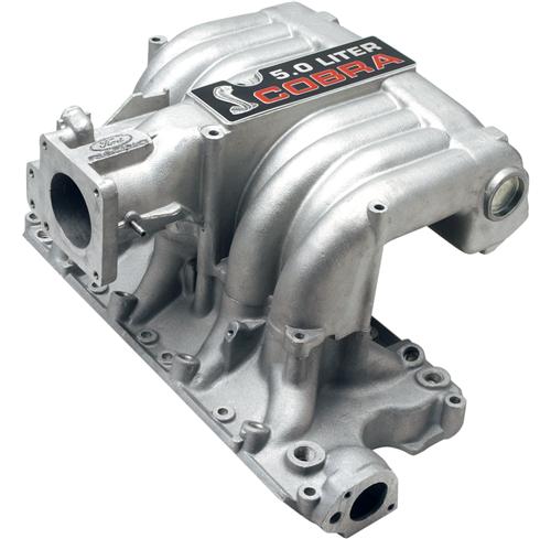

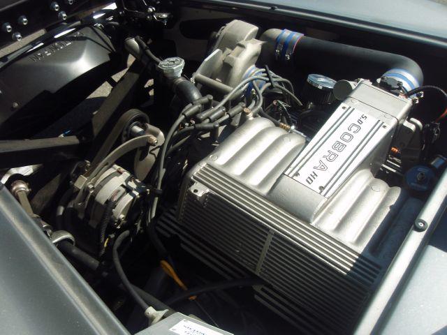

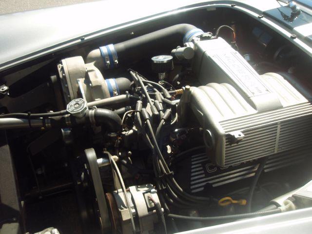

Interesting ride. MIGHT be worth something......
Engine pics to engine write up:
1) Explorer intake, which is advertised as a "COBRA INTAKE MANIFOLD" (or am I mistaken?)
Should be this, right?
2) Ad states "ENGINE FORD 5.0 302 HO EFI W/ENLARGED COLD AIR INTAKE SYSTEM 375HP TO 400 HP ESTIMATE COMPLETE" but does not mention the super charger....
NOT a car guy that wrote it up. No info on injector size, cam info,... Stuff that I would want to know with the supercharger working. I mean, if "PROFESSIONALLY BUILT NO EXPENSE WAS SPARED", where's a build sheet with a parts list?
Sorry, just my $.02
