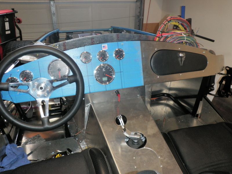

Here are some photos of some of the updates we have made:
Bluetooth remote stereo in trunk with amp and 6X9's in bulkhead.
I fabricated my own frame to hold the stereo, amp and speakers.
Hidden controls for AC/Heat:
Powdercoated Chrome Drive system:
AC Condenser:
Dad and I on his birthday:
Tyler Wayne is offline   Reply With Quote

Update before paint
We are looking to get the car into paint this week and hopefully it ready for the Texas cobra meet in San Marcos in April.
XL Access Panel before bending.
Need to add AC cover
Minimalist Dash:
Body goes on:
Getting more attention:
Relocated shifter, cup holders, relocated E-brake
Added combination USB and 3.5mm jack directly to rear mounted head unit. Charges iphone as well.
