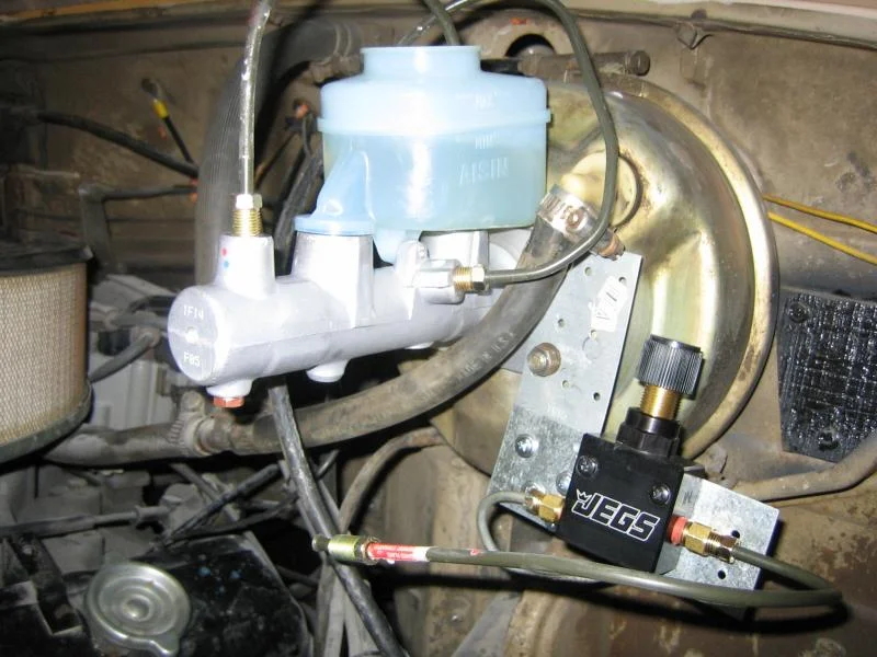

i got my insurance card from Robbin today (e-mail so i could drive right away.)
i took the car out for 40 miles. i 'rode the brake' down big hills, stomped on it, everything i could think of. i even let the car roll backwards down and hill and hit the brakes.
my last master was a stepped one plumbed backwards. i put that right, and the braking is much improved. the feel of the pedal is much better. now that i have the "straight" adjustable brake rod from Breeze the brake pedal is more even with the clutch pedal (top height), and it does not "bounce" past the top. it also does not make a creaking noise, we learned that because the old pushrod was rubbing something.
the problem is that the brake pedal is still "sometimes faded." every 15 minutes or so, it will go 3/4 of the way down with nothing. not that i would really do that, if the pedal is "pre faded" as i call it, all i need to do is pump it again and it's ROCK solid from all the way up top.
most the time it's soft for 1" of travel or so and BAM they are rock solid. if i pump it twice, the second pump would be solid from all the way up top. the 1" of travel is identical to the free-play in my clutch pedal.
i bled the brakes all around more times than i could count, and i saw absolutely no bubbles coming out anywhere. all of the old fluid was pushed out, because all the new fluid going to the catch bottle eventually came out crystal clear. we went through two full bottles of brake fluid.
recently on TV... i don't remember which car show, but it's the one with the 'Larry the Cable Guy" sounding guy... they used a reverse bleeder. there are also youtube videos for it.
Harbor Freight has one for $27, Phoenix has one for $350.
advice?

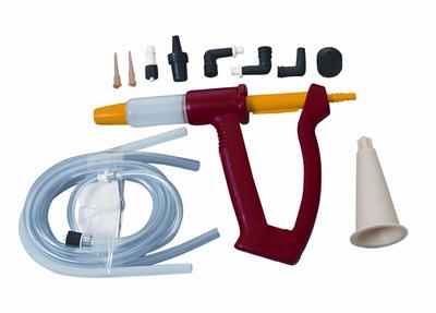

Reverse bleeding is the only way to go in 2012. You'll do it once and be done. The old fashioned way goes against the laws of physics as air likes to go up. So pushing the air up rather than attempting to push it down makes the job easy. Think about how difficult it is to try to push a ballon filled with air down in a pool. Very frustrating. I used the Phoenix. The HF one is...let's just say...you'll wish you had saved that $27 for lunch. I'd also suggest a NEW good old fashioned Jeep MC like you had before. Those Dorman MCs are harder to bleed. I have two of them.

Get yourself one of these: Phoenix Systems reverse bleeder http://www.summitracing.com/parts/PSL-2004/
I just replaced my master cylinder with a Wilwood dual setup. I "bench" bled the master cylinders in the car and bled the whole system in about 15 minutes. I'll never go back to the old way of bleeding brakes.

out of fear of complications, brakes on DD's are pretty much the only thing i pay Pep Boys to do, but when the brakes go on my Tacoma in about a year, i plan to try it myself.
so a quality bleeder tool will be worth the investment.

i ordered the Phoenix reverse bleeder, and i seriously hope my problem isn't related to the rear axle...

here is Kenny with his new blue roadster. he gratuitously showed up to help me "reverse bleed my brakes in 10 minutes by myself."
the Phoenix tool is a good tool for the money, i'd recommend it to anybody. it must be nice to use when filling a totally dry brake system. brake bleeding is a messy job and i hate brake fluid, but it kept it to a minimum. when doing the rears, it was often times very hard to squeeze the trigger, and it would only squeeze halfway a few times. not sure why. i had to unsqueeze it by hand to get the plunger to get back to the first position. anyway, that's the tool.
there were a few times that i considered using it in reverse and sucking the whole system dry, but i did the rears twice, and kenny said he could see no bubbles coming out, nothing but fluid, and we had to drain the master several times. there is the little float in the master, it would be nice if that came out, but i could not get it out.
FFR5452 suggested there was air in the master cylinder, possibly there because i did not prime it well. the good news is that with the first pump of the passenger front, ken said he saw a bubble. it came up right away so i assume it was in the master cylinder. that was the only bubble we saw. by the way, it was much easier to pull the trigger on the tool with the front brakes.
went for a drive and the pedal feels the same. still 1 1/2" of free play but rock hard after that and the car stops very well. but after doing this i thought it would be hard all the way up top.
i did not get any pedal fade. i stopped the car 50x hard, and no problems. but the pre-faded pedal usually came after cruising for 10 minutes or more.
i drove Ken's car, his brakes worked absolutely awfully and i thought i was going to die.... i'm sure it can be improved, but his pedal was rock solid from up top and it seems like the pedal doesn't even go down 1/8" when pressing it. he has the Wilwood pedal box and dual master cylinders. (i don't expect my car to feel like his and i don't want to over-complicate my post.)
i am not sure if i solved my problem. that bubble definitely had to be purged out so it was already worth it. a longer drive is due to see if the pre-faded pedal thing went away.
