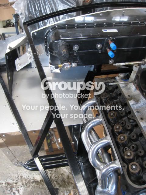

Whitby's new A/C and heater is a very good unit. Very large and very doable with windshield wipers and without the firewall forward kit. In fact, it wouldn't work with the forward firewall.
Whitby's just picked up this unit for sale which is partly or all made by Vintage Air and used to be sold under another name.
Here is the hole cut in the firewall for the unit.
A/C unit mounted in the firewall
My firewall is different than others and puts the unit about 1/2" forward. I mounted a mocked up engine to check for clearances and it all fit. I now have a mirrored stainless insulated box around the unit seen here.
I have not dealt with it yet but the space between the dash and firewall will be real tight. Two tubes for defrost and I think three for the cockpit.
This picture is behind the firewall without the blower unit mounted. Note my firewall has three layers. First .090" firewall, 10mm Pyrogel insulation and then .050" mirrored stainless steel. This is what puts my evaporator/heating exchanger into the engine compartment by about 1/2" as mentioned above.
I have mocked up my windshield wipers and everything does fit. Tight but it does fit.
George

It is a very close fit with EFI. Closer than I realized.
In these two picture the engine is not level.
In this picture it is level, but I had better hook up a transmission and fit the engine block and transmission to make sure I've got the proper room. As I think about it I don't really know what level means until I have a transmission hooked up and have worked out the pinion angle with the drive shaft.
Here is a recent picture with my evaporator insulated and covered up. I will put in that engine block and transmission to see what room I don't have. If there is interference I can just modify the insulated box where the intake manifold bolt would hit.
I'll PM Whitby's to let them know about this close fitting. I already PM'ed them.
I also looked at your build thread and it looks like you have not yet riveted the forward firewall into place. Or have you? Can you do without the forward firewall? Maybe Richards A/C unit would fit with the forward firewall, but I'm thinking you already have the Whitby unit. What to do???
George

I would think through that false floor. The seats mount to the floor - or on very low profile sliders. There really is not much room to run ducting. Raising the seats would most likely put your head above the windshield (some tall guys complain about that with their seats mounted on the floor). You also have think about how that changes the angle to get your knees under the dash and steering wheel.
I guess my question is what are you trying to solve or accomplish with your A/C? There are a number of proven solutions - Do you have a need that one of them does not solve? Are you just looking to do something to be unique? I am just trying to understand where you are coming from.

You misunderstood what I meant on the false floor. Just from under the seat forward, raise the floor about an inch, have a vent hose under the seat, and blow air into the foot box. No one will ever know its there. Yea, I like trying to come up with different solutions for the same problems. If everyone did the same things, nothing would ever change. Maybe I make things better, maybe worse. If it's worse, it's not like things can't be changed again. I try not to cut things up too much, and usually think things through before messing up. It's more fun to be creative than just bolt things on and have them work. And I learn something new everytime. My next project is to build an aluminum body for the cobra. I think I'll learn a lot if that ever happens. Mike
