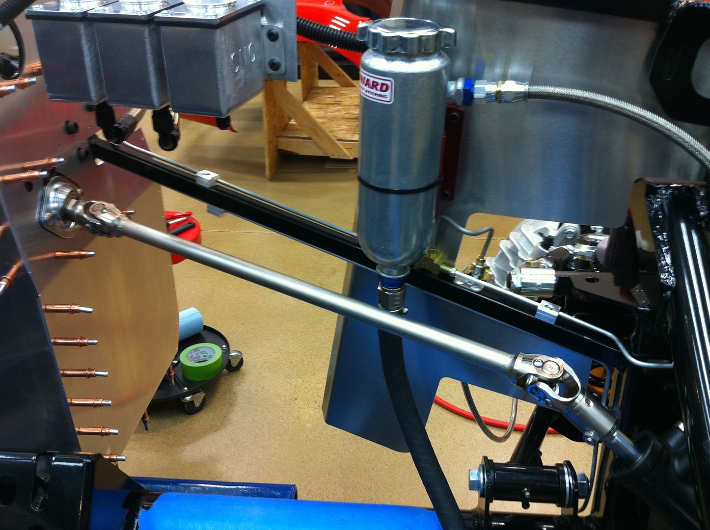

Power steering
My vote is Yea, especially if you are only going to drive it on the street. That's when you need it the most. You can add more caster when you have PS and that makes the car track better in a straight line. Mike Forte sells a Ford AC eliminator bracket that makes it easy to put a stock Mustang PS system in and you can cut the pressure spring if it is too much boost. It doesn't have a big bling factor, but it works well. I did use a small cooler and -6 AN teflon lines but you can get a hydraulic shop to make up some PS hoses to fit.
Ron
