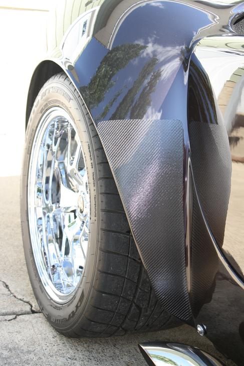

I'll be putting on the carbon fiber ones from Factory Five. They seem pretty hefty and should prevent rock chips, or at least minimize them.

Made mine from black vinyl, top and bottom attach with a small bungee cord and taped to inner fender behind Alexs inner fenders. Vinyl is cheap, I had maybe 20 bucks in material even after a few redos. Protects good with my billboards.

I'm not sure how well leather of vinyl would hold up to rocks. They are inevitable. So I opted for FF carbon fiber ones. Measured a gajillion times, trimmed a few times and finally stuck them on. Turned out great.And they are tough.
Perry
That's probably what I will end up with. I just really liked the look of the tall leather ones the Alex used to offer.

Why not cover the carbon ones with leather or vinyl if you prefer that look? Attach them the way I did, with velcro strips....
Not a bad Idea, I think I'll try that.

Spats
Hi
I made my own spats from the unused dash covering that was supplied with my MK3. First I made a cardboard template of the area that I wanted to cover, once I was happy with the design I traced it on the foam back side of the dash material. I then enlarged the whole pattern by 1 1/2 inches and cut it out. Then carefully remove the foam backing from the
1 1/2" border, fold over the top and inside edge of the stripped vinyl and glue it to the backside of the foam. Use a good two sided tape and put the spat in place, then using 2 sided tape fold the outside stripped vinyl around the lip of the fender and stick it in place. The beauty of this is that they are easily removed for car shows or a good cleaning. Mine have been in place for 3 years, every once in a while I have to touch up the tape but my fender flares are like new.
Hope this helps.
Cheers
Allan
