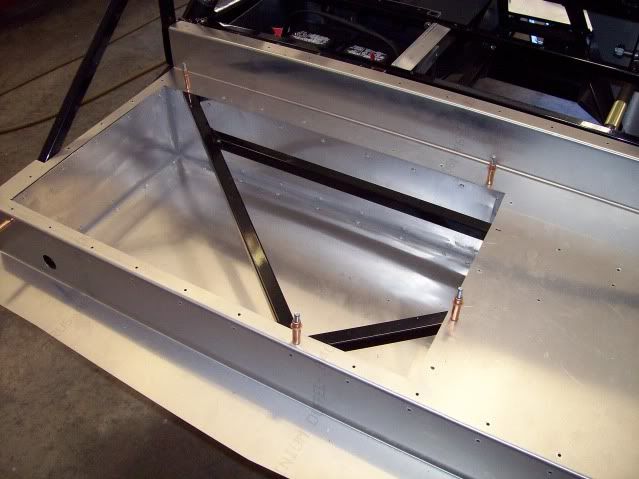

Here is my DIY job. It was quite the custom fit job to say the least.

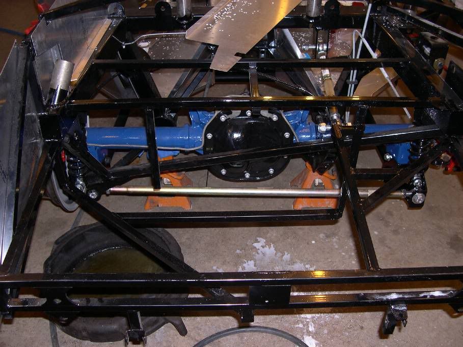

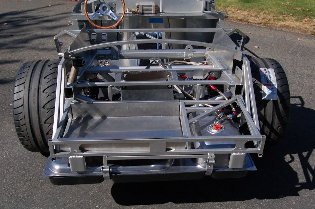

Here's my DIY. Mine is a Mk3 so it is configured a little differently than your later Mk4 with the raised floor but the concept is the same:
I chose not to cut out the structural tubing but even with it in place I can still fit two helmets within the triangles or put all kinds of soft bags and other stuff under or around it. Expanding the trunk is one of the best mods you can do in my opinion.
Good luck,

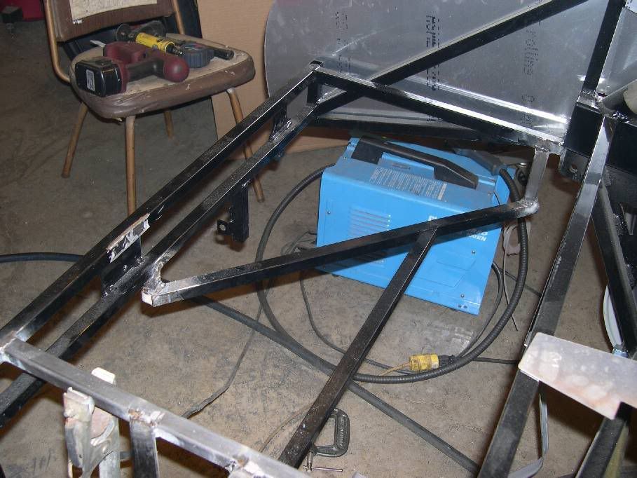

Here's my attempt - this was one of the reasons I got a welder - the first cut is the hardest, once you cut your first 3/4" tube, the rest is easy! To be honest, I don't think FFR puts enough reinforcement around the gas tank - I cut those bars out that you can see in the above pictures, but added considerably more protection around the gas tank. I think I have some more pics somewhere if you want to see them...

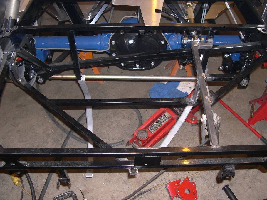

Here is a shot of my modified trunk. I re-worked the structure to be just above the fuel tank for the floor.
I also made the rear bulkhead go up to the body which made the area above the differential a cockpit accessible storage area.
The horizontal strip in the front of the trunk floor is the cover to my "Deep Well" trunk area which is the full width of the chassis and goes down to be just above the bottom of the differential. It fills the space between the differential and the fuel tank.
I also did the "full drop butt mod" and cut the original horizontal tube, at the back, down for an easier "lift over" access to the trunk.
Regards, Rick.

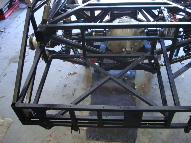

Here's mine. Did it a week ago. Take measurements, cut, bend, repeat.

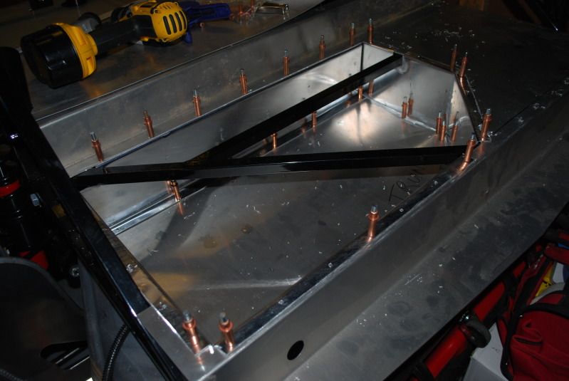

here's mine...to start-
24" long x 10 1/2" wide x 5" deep when done...I hope

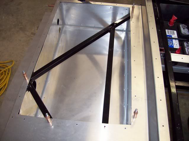

Added Under Structure
Originally Posted by MPTech View Post

did anyone run a brace across the bottom? (underneath) the bottom seems kinda bouncy.
I made some structure to support the trunk floor area. I made it so I could do most of the welding outside of the chassis area, for convenience of work space.
Regards, Rick.

I am also looking to mod my trunk. Cobra Earl indicated to me that he doesn't do trunk mod kits anymore. He did not want to get stuck with inventory that wouldn't fit the MKIV. I have been watching Harbor Freight for a brake and they now have their 30" brake on sale for $35 through their inside track club. See picture for coupon, this sale is for the month of March. I think I will give it a shot to make my own footbox, F-Panel and trunk mods.
Rick, I like your idea of making the trunk brace changes outside and then just attaching the assy. I already have a powder coated frame and the rear end/3 link in. Do you have any pics of the chassis before you put this in ( what you cut out)?
Thanks, Bill
