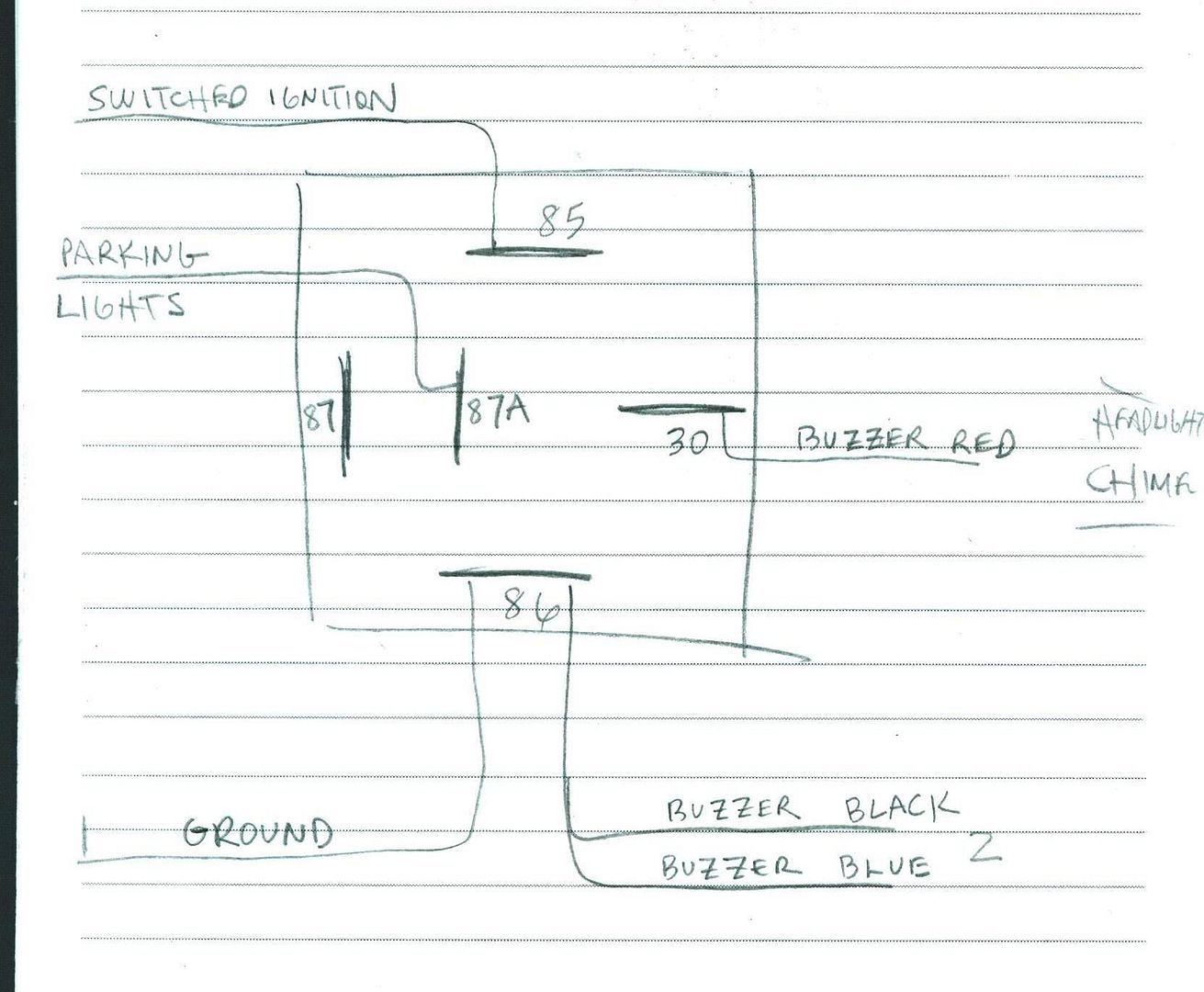

I put one in my build when I did the dash wiring. Used a Radio Shack 273-071 80dB chime. Wired with a relay to chime when the light switch is ON (in either park or headlight position) and ignition OFF. I have the schematic somewhere in my file at home if you're interested. The commercial products mentioned are fine (and maybe a bit cheaper) I just decided to go this way. I worried because both of our DD's have fully automatic lights and I was positive I would forget and drain the battery at some point.
Note: The 80db chime was way too loud. Didn't need to be reminded that much! I mounted the chime face down and it was just right.

This is how I wired it. Radio Shack 273-071 80dB chime and a standard relay. This is from my shop notes. Only thing missing is some greasy fingerprints. You electric wiring gurus don't beat me up too bad. It works.

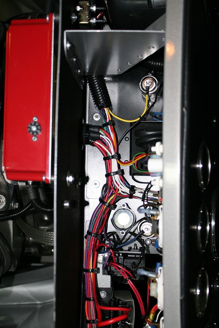

Here's a partial picture of the dash wiring, before the body was installed. The Radio Shack chime is the round circle just below center. I mounted it face down, and could adjust the volume by how tight I made the mounting screws. There are two relays below it. The one on the right is for the chime. The other is for my fog lights.

I like the sound of the chime and think I'm going to go that way. I have an extra relay in the garage so all I'll need is the chime. Thanks for the great video. Bye the way your wire routing is impeccable.
