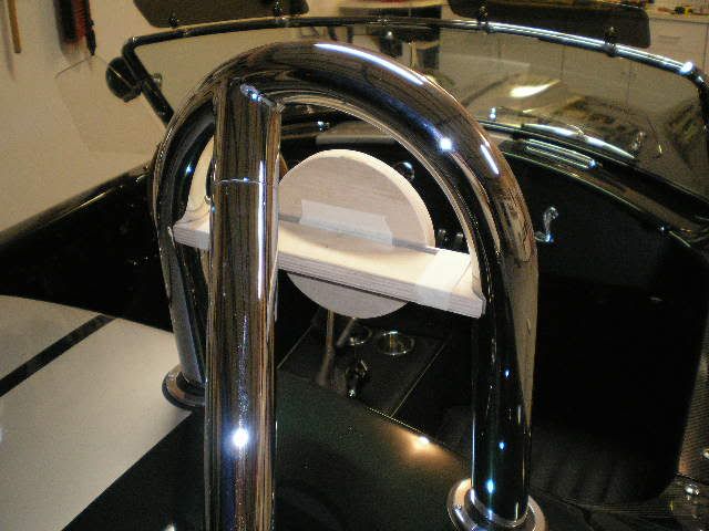

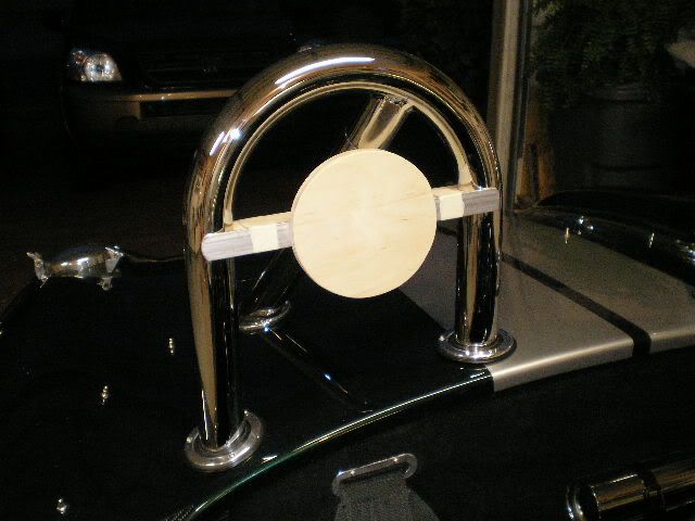

I made these small round headrests a couple years ago, but never used them and have no idea what I did with them. (that happens when you get old!)
No pics of the finished product, just these mockups. I made the brackets out of heavy aluminum and attached them to the bars with industrial velcro. Made the pad out of 3/4" hardwood, put 1" thick foam on it and covered the whole thing with fake leather. When I was all done, I realized I didn't really like the look of headrests on these cars. To each his own.
