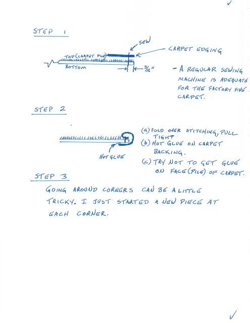

Carpet edging instructions
Daryl:
It is actually not too hard to do if you have access to a sewing machine. Basically you sew the carpet edging along the pile side close to the edge and then fold the edging over itself (over the stitch) and then hot glue it to the back of the carpet.
Here are a couple of examples of what I did:
Let me know if you need some of the edging as I have extra.
