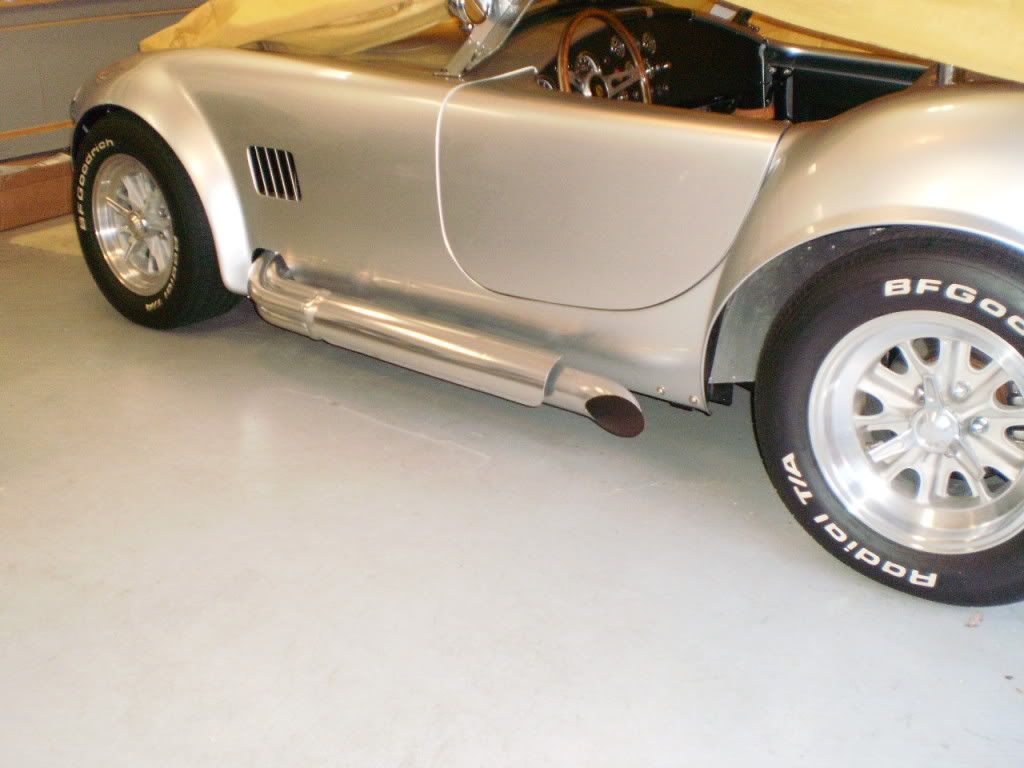

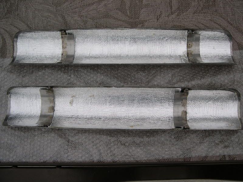

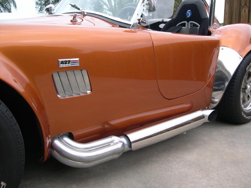

here are the photos
I just bought some stainless steel exhaust heat shields from Mike Francuck, forum member.To help improve the thermal resistivity I glued on some "Thermo-Tec" heat barrier from Summit on the back side. I first cut the material inside the parmiter of the shield, then masked off the edges and the attachind supports before spraying the glue on the metal. I also sprayed glue on th thermal sheet and placed it on the metal immediately so I could slide it under the attaching supports.(you only get one shot when it's dry as you all know).
I tried polishing the sheilds my self, using about 6 grades of paper followed with polish, however doing stainless steel was significantly more difficult than I was used to compared to my aluminum polishing experience. After 3 hours I declared "UNCLE" and brought them to my local Metal Polisher, who did them right for a good price at only one hour of labor each. (I guess I could have choosen a better back ground for the photos). Here are a couple of photos of the shields before and after I installed them. I love Mike's product, very nice workmanship, beautiful product!
