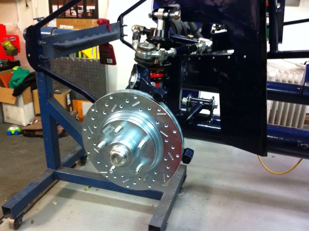

Here's a picture of my stock Ford brakes next to my new Wilwood racing brakes. The brakes came as a complete kit from Gordon. They included everything I needed: every bolt and screw. The only thing not in the box was the fluid; and he would have sent that too if I asked him.
These are the rear brakes.
