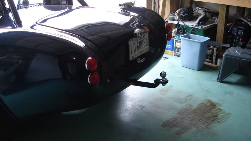

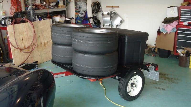

Take a trailer to the autocross
Toyota Yaris hitch with vertical receiver and a Harbor Freight trailer.

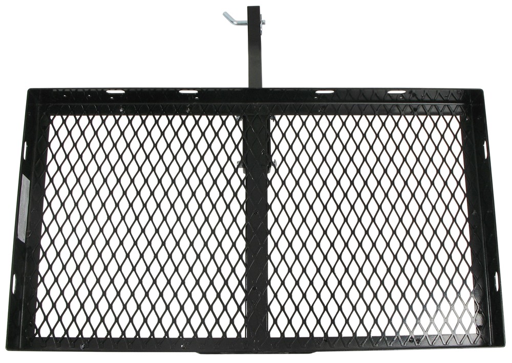

i saw the ball-hitch above, i was going to suggest a bolt-in class 1 receiver hitch and one of them cargo trays from JC Whitney.
i've actuaully thought about this myself, i have a bike rack and a snowboard rack that bolts into a class 1 receiver hitch. used it for 20 years on my Integra.
your hitch doesn't really need to be so strong to tow 2000lbs. i took the hitch off my Integra when i sold it, i've been figuring out a way to bolt it to the roadster. it's not the "wide" kind, it' about the size of 1/3 a shoebox.

P Matt & Yaris
Can you post a photo from under the rear of your car, showing the install of the Toyota Yaris hitch?
