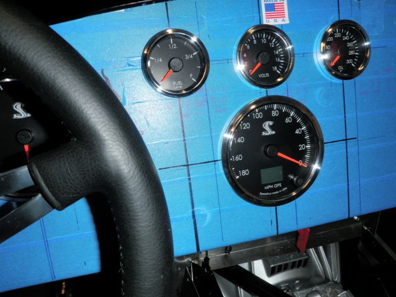

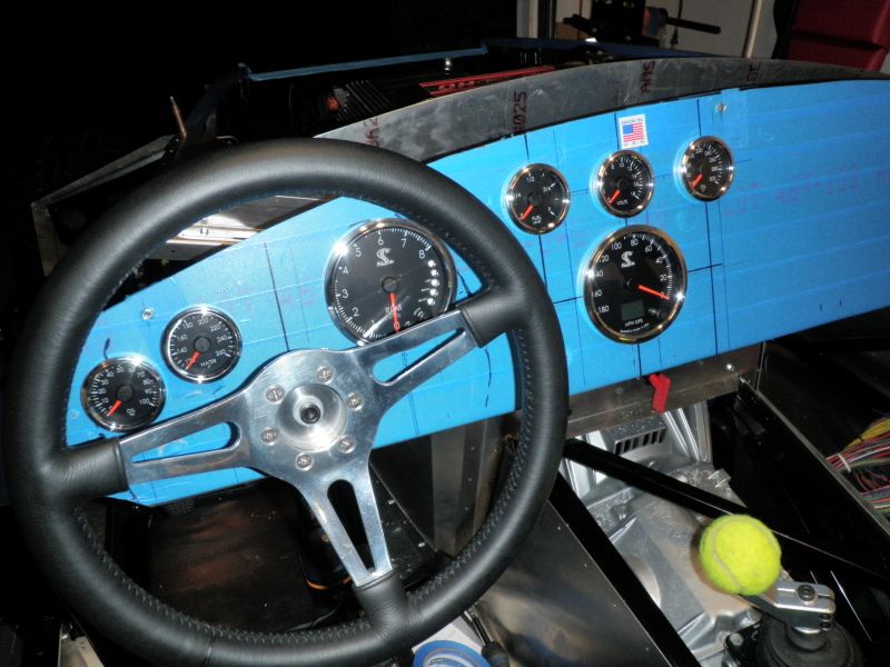

Drilled my dash and installed my gauges (also installed my battery cut-off switch). Cut and partially installed my firewall forward last weekend. Trying to get it all setup to start wiring.

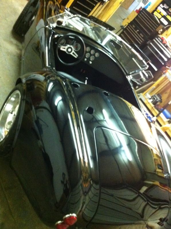

Posts: 3,939
Originally Posted by The Federalist Patriot View Post
I hadn't seen pics of the flip with color, etc.
I hope you post some shots of your tilt front in Stinson Pilot's "Tilt Front----Update thread. I need to see more of that!
Here's one with the front partially open.

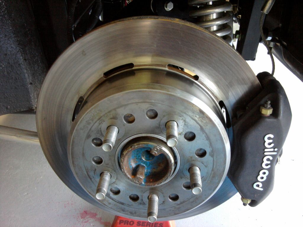

6 months & 10 car-washes and these babies rusted right up. i cleaned them off and shot them with clearcoat. you can easily see the hubs thru my Bullett wheels and they looked awful. they are by no means shiny, but at least they don't look dodgey.
yes, i flipped one of the photos and yes, i was careful to mask off where the pads go and yes, it's high-temp clearcoat.

boowliw?
Yeah, I was wondering where you got the "boowliw" calipers from...

Oooo... Nice idea Eddie! My car isn't on the road yet but I thought about maybe powder clear coating or clear painting the inside of the rotor the same way. BTW... I see you have the Wilwood adapter ring for the rotors. My Wilwood instructions said the rotors were hub centric so the rotor adapters were required. I see your rings have some space around the hub. Mine did too because I had Yukon axles with a smaller hub than the Mustang axles so I ordered the Willwood larger rings to fill in the space around the hub.

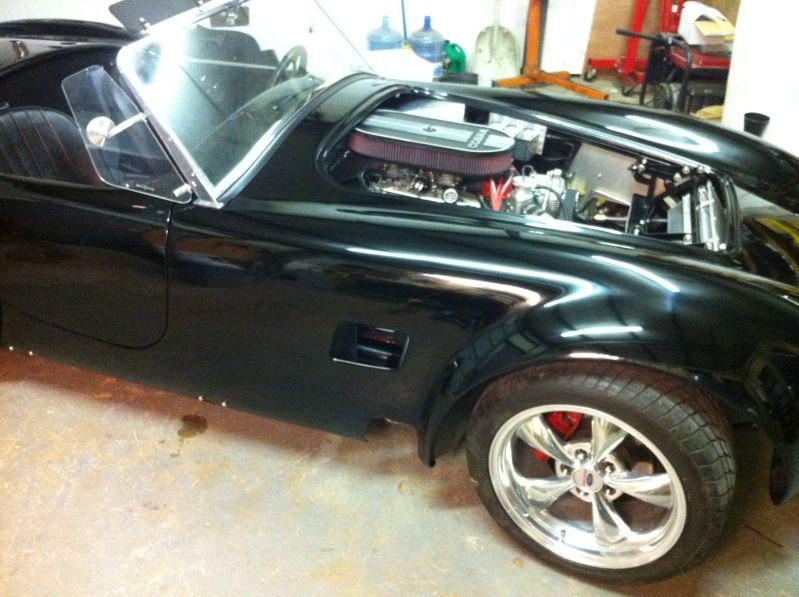

Started mounted my freshly painted body. Hood should be ready tomorrow, still needs a little buffing but looks really, really good in my opinion.
Sorry for the crappy iPhone pics. Will try to get some better ones later.
