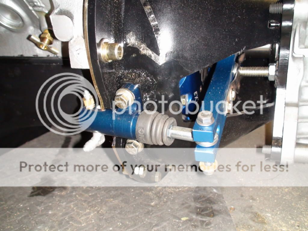

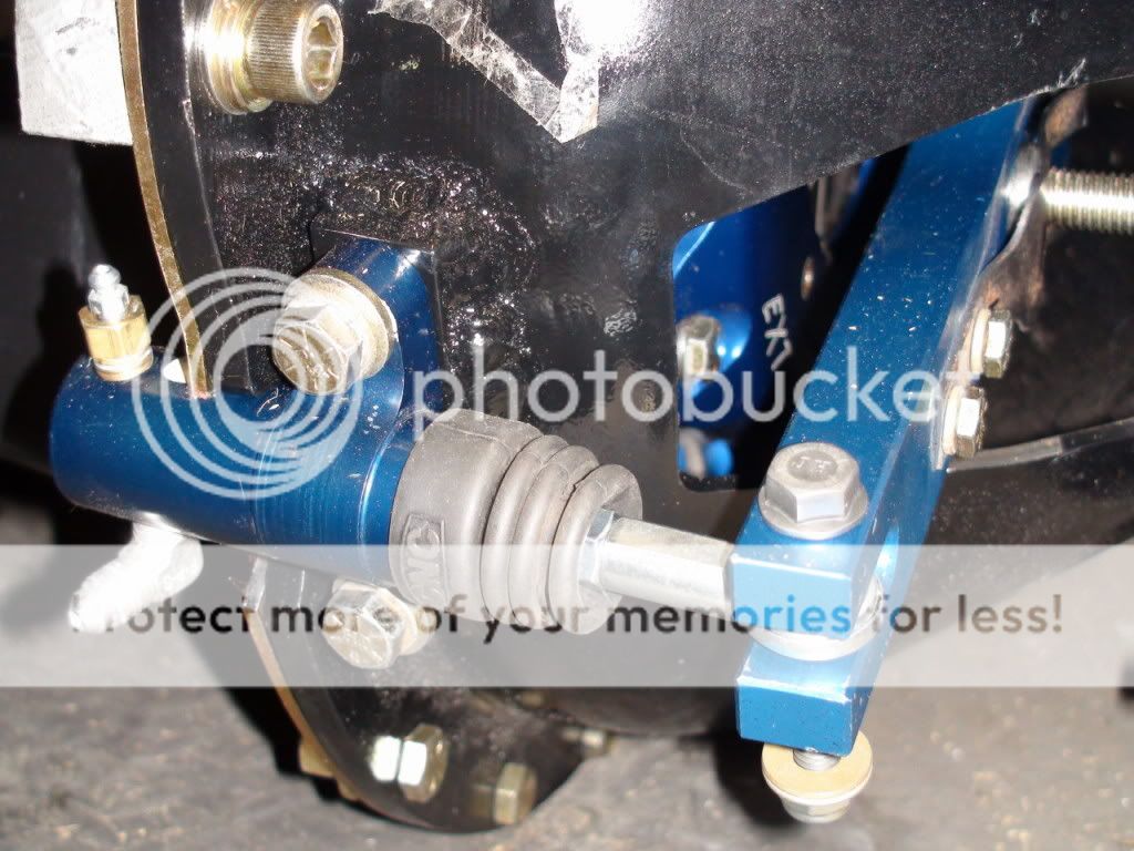

The push slave kit I have developed is to replace problematic other hydraulic release systems. Whether it be a hydraulic throw out bearing, or external pull slave, I've tried to make a better system.
The Wilwood pull slave works as you can see, but the piston seal and the shaft seals are both ""O-ring"seals. My experince with customer problems is that eventually they do fail rendering the clutch pedal useless and your car needing a tow home or to a shop and money spent to fix it....
I really am trying to offer a better product that serves you better.... It can't be all to bad, Kirkham copied it and sells it for $100.00 more than I do...

I also have a low profile weld on bracket for the billet slave & fork. I machine the bellhousing for clearance of the slave making the slave about 3/8"off the lip of the steel bellhousing.

Mikes Quick time solution
Here are some pics of the solution for Mike Forte for the Quicktime bellhousing and a push slave.
CLASS OF 2009 # 79 FFR MK 3.1, # 6898, Complete kit arrived 02/07/09, roller 03/30/09, first start 07/14/09, Registered 10/14/09, PPG Orange Glow over Sterling silver, Dart aluminum 427W (445 rwhp), stack fuel injection,on board fire supression,Front Runner Serp system, TKO 600 mid shift mod, ISIS system, Hydroboost brakes with Willwood pedals, PS, A/C, IRS, Griggs racing front suspension, Foot box mods both sides,Dark Water splitter,dead pedal,glove box. (where's my publisher) Lots o Goodies
"Speed has never killed anyone. Suddenly becoming stationary… that's what gets you." -Jeremy Clarkson
rscocca is offline
post #29 of 32 (permalink) Old 12-05-2010, 01:37 PM
BigLeo69's Avatar
Join Date: Dec 2008
Location: st. louis missouri
Posts: 4,499
Icon21
so Bob
that quicktime set-up
what keeps the fork off the pressure plate? that bolt to the back is that your adjustment?
when u look at this first it looks like a pull.
that cnc has i believe a 7/8" throw to the cylinder, is there room for adjustment at the hine joint.
it seems like it would need a return spring for the cnc to have some resistance to releave itself.
