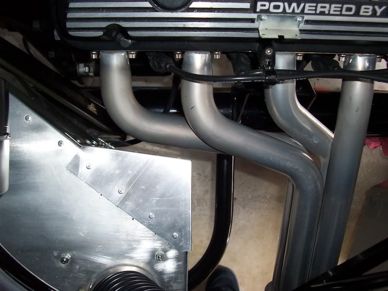

302 w/ same headers as you.
there are instructions in my link below to make an expanson like kelownacobra.
my cost was $18, i used only one (1) 24" x 24" sheet from home depot.
a few inches makes all the difference. well worth it and highly reccomended.

Eddie, are those BBKs? They sure stick out a ton for 302 headers. Here is a pic of Hookers on a 351...
