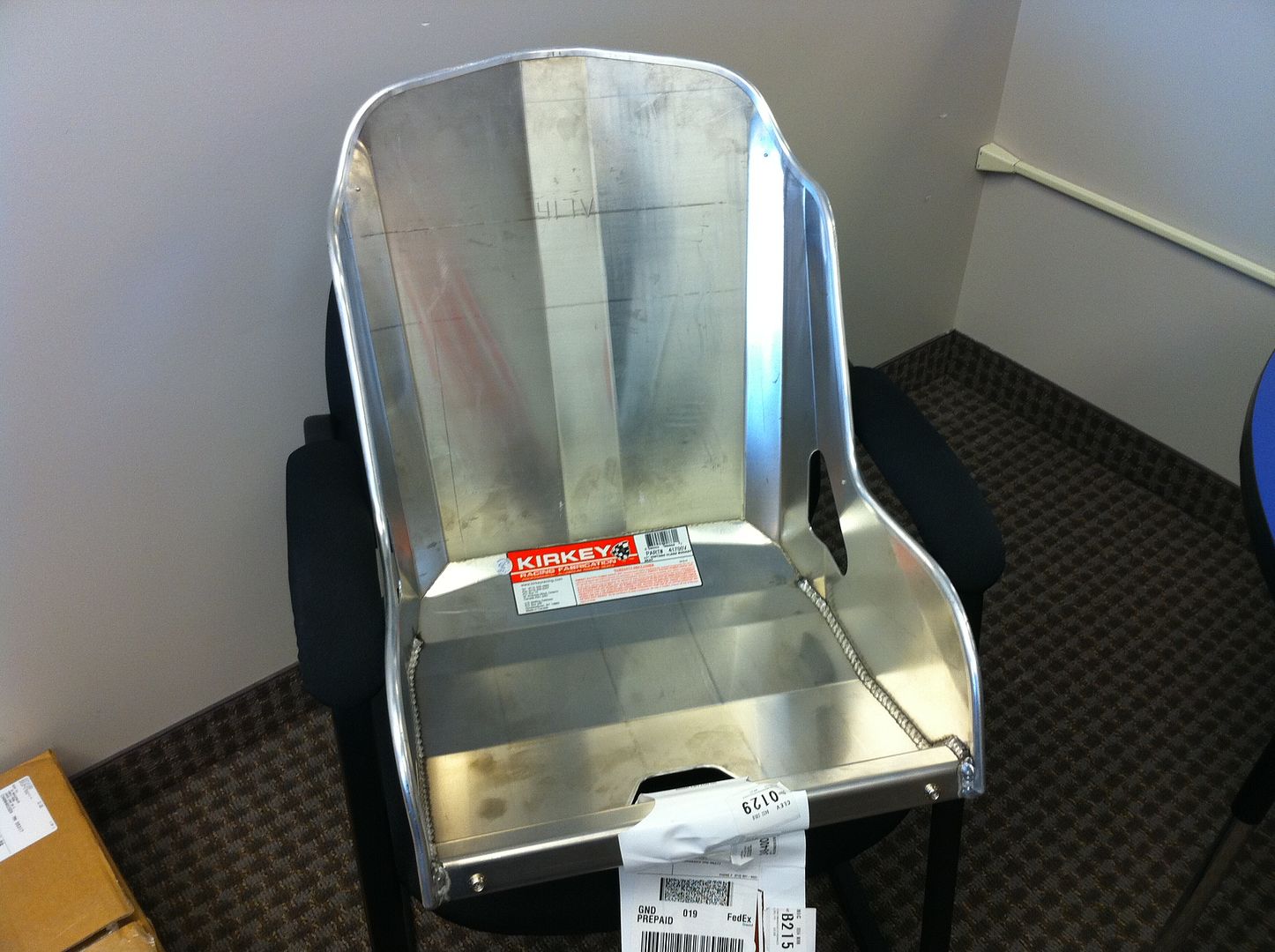

I'm testing fitting Kirkey low back vintage racing seats later this week (I need/want the leg room and want to sit lower than the factory seats allow).
I'll have a couple unique elements, but nothing crazy.
Mid-shift, no radio, no heat, no wipers.
All Business
Do the low-back or high back kirkey seats get you the most legroom? I'm a tall guy - worried about the same once I order my kit.
That's what I've read.. They are very thin.
Summit just kicked one to me from Ohio (literally - shipped without a box - goofballs). /rant
Pic of my bare Kirkey seat - seatcover/foam is extra and a link immediately below to an old thread showing these seats in a Mk.2/3.
I like retaining the vintage look, providing more leg room while letting me sit further 'down' into the car. Not for everyone.
They come in 15", 16", 17", 18" widths.. I'm trying a 17" with the cover/padding tomorrow and will report back. I'm 6'0 and 200lbs - 35" waist (well, more often than not).
Kirkey low back seats

Chris, I have the same seats. I tried them on the floor and also propped up on a couple of 2x4's and being up just that 1 1/2" seem to make a difference in how they felt. Are you planning to use the seat mounts from Kirkey? I'll still in the air about how I am going to mount them but maybe that 2x4x1/4" aluminum angle you used for the reservoirs would work for the seat mounts. When you see a picture of the Kirkey mounts you will know what I mean. I'm 6'2" and 200lbs and have the 16" seats. They are snug but I like the feel so far.
Hi Mike.
I am planning to use the Kirkey mounts (below). I don't have them here, but from memory, it seems the lowest hole is about 1" from the floor. There is room there to drill yet a lower hole I think.
My 'test' seat is 'sitting' in my office (ha), but I'm going to try the foam/cover this weekend to see how I like the 17".
I don't mind running some additional medium density foam under the cover for auto-X to take up a little wiggle room, but I don't want it too roomy. On the flip side, I don't want to have to lube up to get in them for street driving, and I'm certain to have offers to test drive my car from those with a few more lbs. (I'm working on a user-controllable rev limiter, like a valet switch).
I am also planning to use their seat-back mount.

Chris, Here is a picture of my old cover. I didn't realize I couldn't get to the last bolt until after I powdercoated everything. The corner held it very well and like Darren I sandwiched in a piece of aluminum in order to allow the cover to slip in. Not very pretty but you couldn't see it after the body was on.
