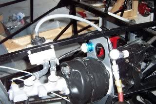

As mentioned earlier - I just used a spare cap to connect a tube to a small regulator. 3-5 psi worked great to bleed the brakes.
