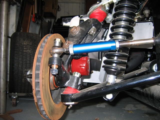

Your bump steer is upside down?

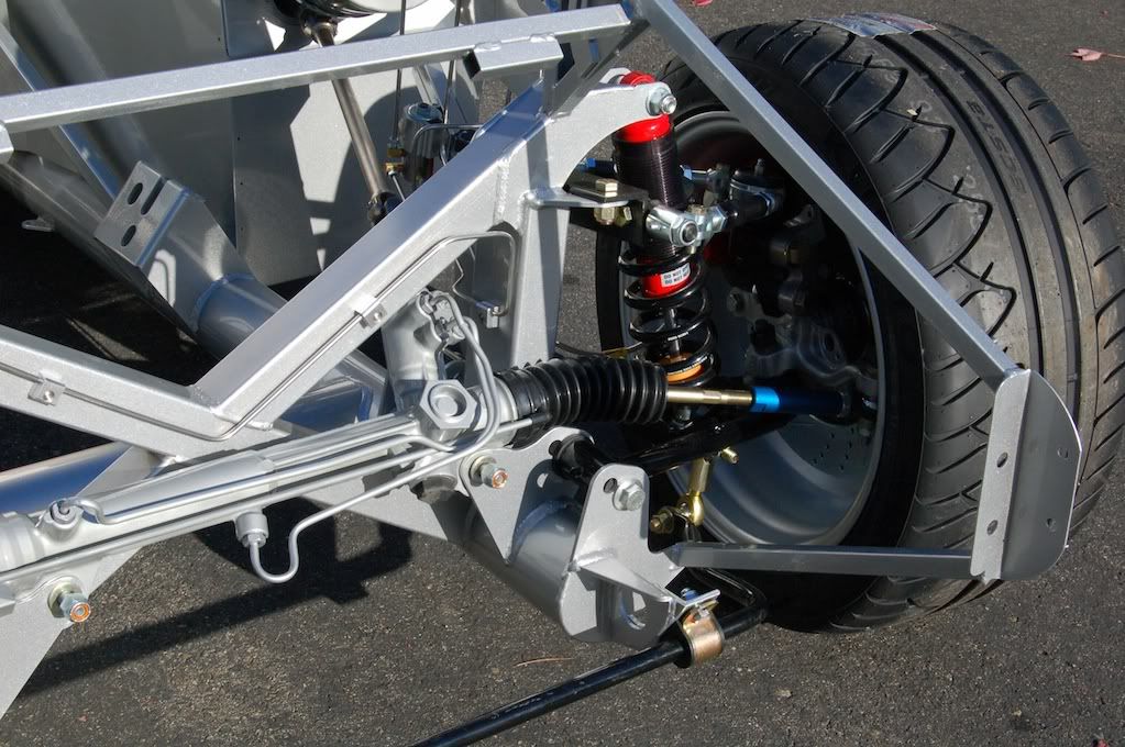

Yep...
I think this would be correct..
Credit NiceGuyEddie..

I dunno - I thought I had it set up parallel to the LCA - it's deceiving looking down on it - here's a better pic maybe...

It can go top or bottom depending on some other factors with your setup. Parallel to the LCA is a good starting point. To really see if you are set in the most beneficial position you should remove the spring and cycle the suspension through the range of travel while noting the change in "toe". Use the position that results in the least amount of "toe" change through the range of motion. Like most suspension tuning there are some compromises.

I'm not trying to sound like an ass. I find it amazing, people spend hundreds of dollars fixing problems they dont even know if they have or not, then arent sure even if the parts are correct. How can you know if you have bump steer if you havent driven the car? I have several hundred miles on mine and have not yet experienced a bump steer issue, maybe I will under the right (wrong?) conditions, if so then I will deal with it.
Bump steer is a matter of geometry. You can check as described above.
