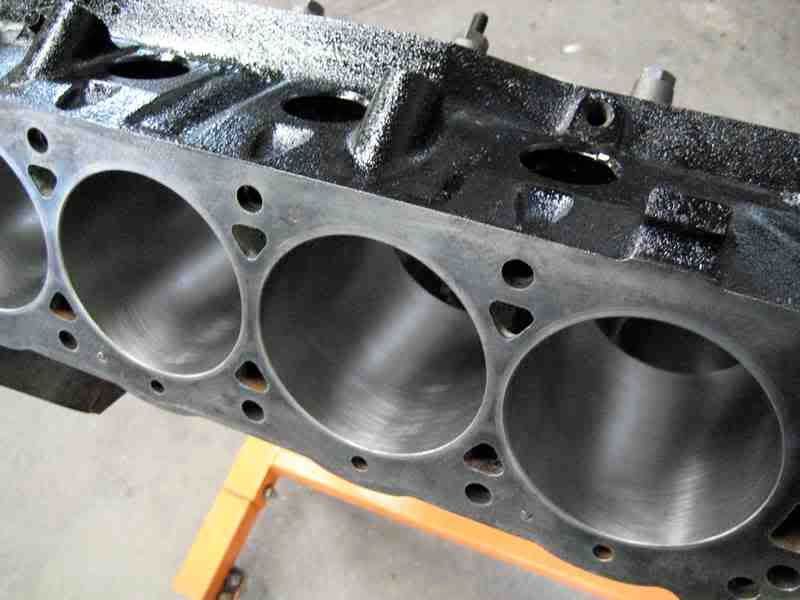

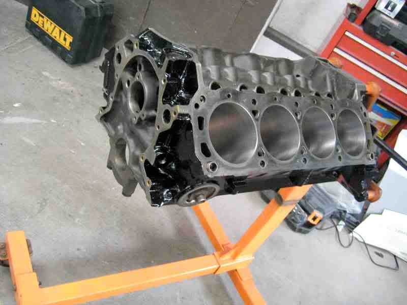

I am not sure that it is the best year to rebuild, but I have a 1968 302 that is ready to be rebuilt. Apparently, 1968 is the first year that the 302 was made. I'm not sure if that is a good thing or not. All the machine work has already been done to it. I have the crank, rods, timing chain cover, backing plate, harmonic balancer, and a box of hardware if you are interested.

I can't tell if the block pictured above has been converted to a roller block or not. It needs to have the holes drilled in the valley for the spider hold down bolts, and have the lifter bosses milled to accomodate the dogbones. Alternatively, if this block is used for a roller setup, you'll need to buy tie-bar roller lifters.

I am 99% sure that the block is not set-up for roller lifters as-is. The hardware you mentioned would have to be added.
