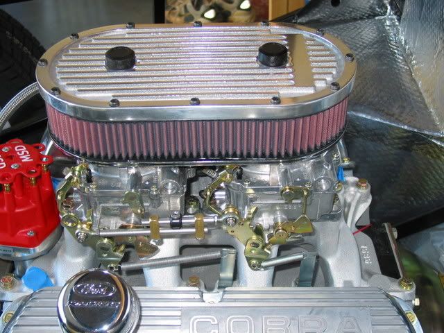

And for those that don't believe it happened:
