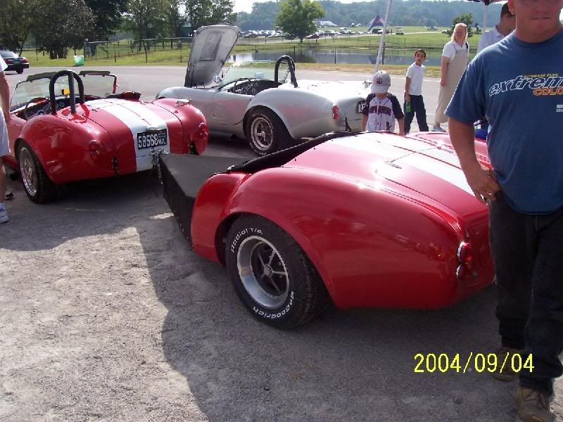

That top shot of Brad's car and trailer was from VIR Nationals. That's my car next to his. The trailer was great, as it was about a 4-5 hour drive to VIR, we threw tents, and other camping gear in it.
Do a member search and email Brad, his memeber name, as stated above is Colonial Cobra.
At one time he was going to build them, but I know he has a number of projects going. He'd gladly answer any questions.

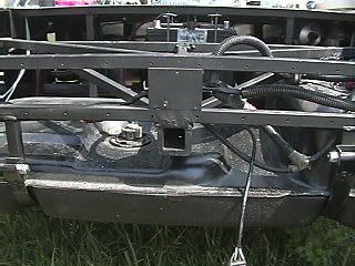

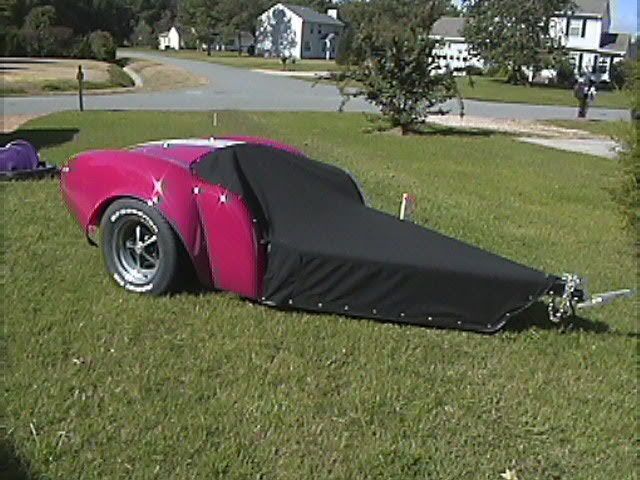

Here's a few more of mine. Rod posted a few already.
And my hitch.

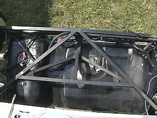

Here you can see where the hitch inserts into the box tube.
We test drove it with a 300lb tongue weight. but my trailer is closer to 80.
Tow's like a dream.

Hey Brad, thanks for the pictures they look very cool. I think I will copy your hitch idea, also like the trailer. Can you store anything under the canvas?
jim
Only a few things like; a full set of race tires, a spare street tire, Jack, tool box, two pop up shelters, cooler.
The entire front is storage. The sides are 12" high and the floor is diamond plate. I just have to offset any weight in the front with thinks in the back to keep the tongue weight right.
