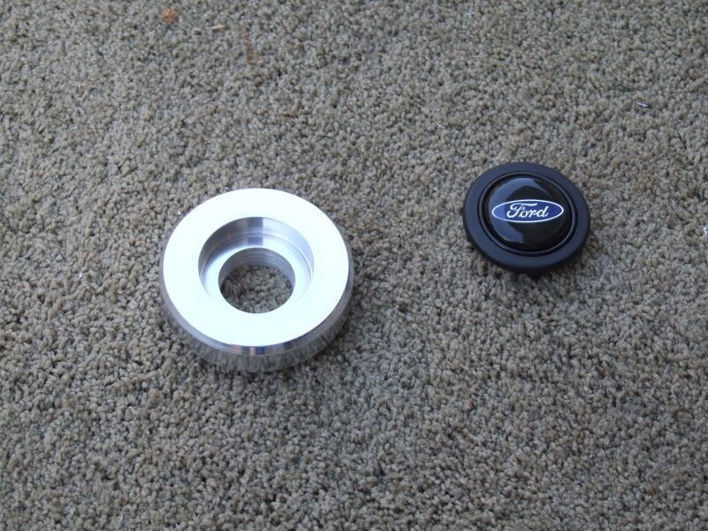

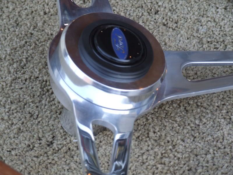

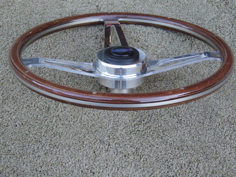

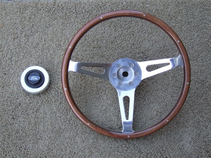

Since I started this build, I've been working hard to figure out a way to get the horn button in the center of the wheel. Once I saw DV/DT's turn signal mod, I figured out a way (Ford Probe Turn signal). Thanks to DV/DT, I stole your idea and ran with it. I figured if I found a horn button small enough I could machine a center cap for the steering wheel and install a nice little horn button in it. Turns out Grant sells buttons for their steering wheels separately. I found one with a Ford emblem on it I liked and then needed to find someone to machine the part for me. Enter Cannonball Cobra (Paul M). Paul has been a great help and true Friend throughout the entire build. Paul just happens to have a machine shop in his garage and when asked said he would be happy to machine the part for me. He modeled the base after the stock FFR piece and on the button base I gave him free reign. I would have been happy if the finished piece was no thicker than an inch. Paul had no intention of letting it end up that thick and manage to machine the actual Grant piece down a bit so the finished piece is only 3/4" think. Exactly the same thickness as the hub supplied by FFR. I keep telling Paul that a bunch of people would want this piece on their car. He is convinced no one will want to pay the cost that the machining take. I don't know? I would. Even though I have tried to compensate him for the material and his time, He's having no part of it. Maybe he'll let us have him over for dinner. Well Thanks Paul. I've said it to you many times already but, here it is again. I am very happy with the finished piece.
Back of horn button and new machined part.
Front of them.
Finished assembly.

I made my horn button using the Grant's Billet horn button that I got from Summit Racing, that with a little elbow grease and I have really nice horn button that only cost me around $35.00 total. Picture isn't the best but gives you a good idea.
