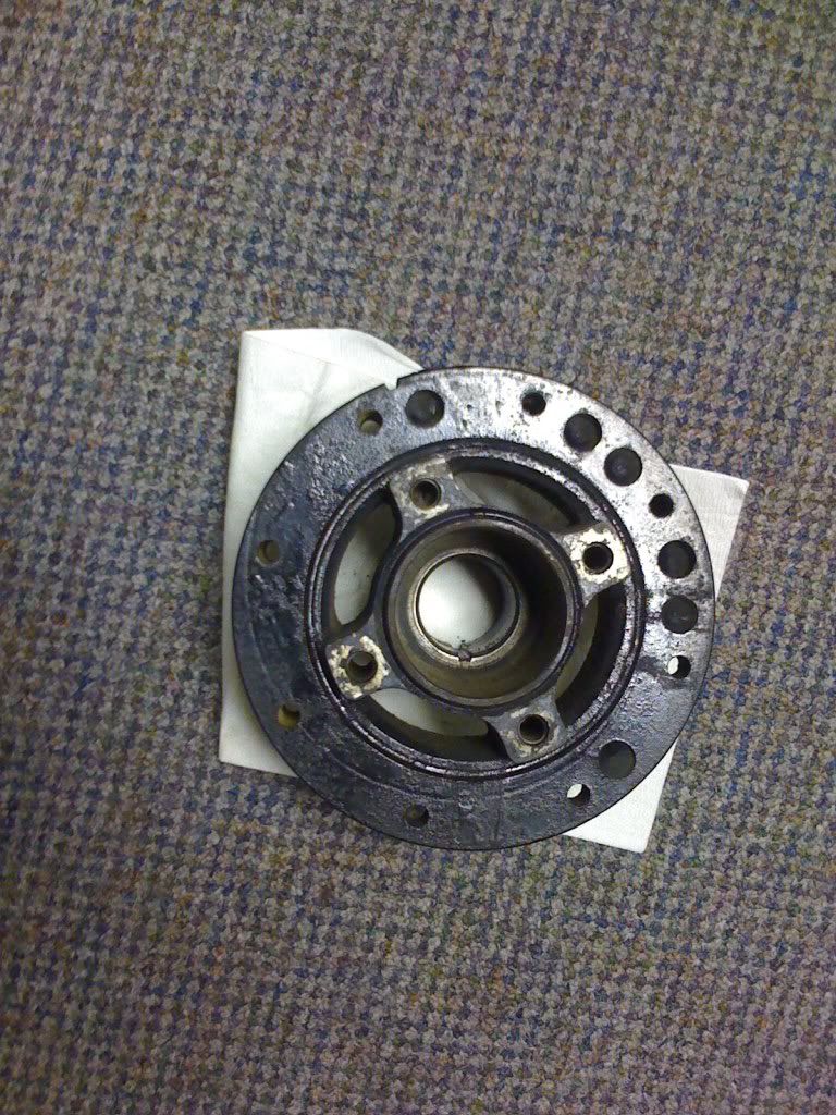

28 oz vs 50 oz harmonic balancer
I have a 351W stroker motor. I was told that it was 28 oz. balance. How can I tell the difference between a 28 oz. and a 50 oz. balancer? Here is a couple of pictures of the balancer that I have. Is this a 28 oz. balancer?

I thought I saw something, that was the 4 hole balancer was a 50 oz and the 3 hole was a 28 oz. This is the mounting holes for the pulley

That balancer looks very used up. I would buy a new one. They are about $50. Cheap insurance for a 351 stroker.

Joe, I agree. That is why I am needing to know if this is a 50 or 28 oz balancer. Anyone know how to tell?

Thats a 50oz. A 28 will have half of that weight.
All 351w are 28oz. Most strokers are 28 or Zero.

Stock 351w 28oz balancer:
Looks to me you have a 50oz off a 5.0/302 later 4 hole. Looks more like a 5.0 86 and up.

I have to agree. The balancer looks the same as the balancer on my donor 302 out of my 88' GT. I am just a bit confused about the balance.
I plan on having crank rebalanced, but was hoping to get a new correct balancer before I bring it in. I have a new flywheel with a bolt on 28 oz weight already. I guess I need to get the 50oz weight for the flywheel and bring it in to verify that it is the 50oz balance. Is it possible that this crank (4.170 stroke) could be balanced 50 oz?

If you have a 28 oz flywheel, use it. The flywheel and balancer both need to be 28 oz imbalance. To rebalance a rotating assembly to 50 would be very expensive, requiring slugs of mallory metal be installed in the crankshaft. Also, if the engine is assembled, you will have to completely disassemble the engine for the rebalace. If this engine assembly has been previously balanced, it will be at 28 oz. Buy a 28 oz balancer and use your 28 oz flywheel. I don't understand why you want to have it balanced to a 50 oz imbalance. A 28 oz imbalance engine is easier on the bearings, and runs smoother than a 50 oz imbalance.

The best option is to have a zero balanced engine - ie it is balanced internally on the crank shaft and does not require weights on the flywheel etc. When you have your rotating assy balanced, you need to take the flywheel and the balancer in. Usually the weight on the flywheel will get adjusted a little rather than the balancer (if needed)- this way if you need to change the balancer you don't need to get the whole set up rebalanced - you can just swap out the balancer. If you need to replace the flywheel then you just switch over the weight from the old flywheel to the new one. The less weight needed to balance (ie zero vs 28oz vs 50oz) means that there is less rotating mass and the engine will be able to rev faster. The 28oz is a good compromise between achieving that goal without the expense of zero balancing.

It's my experience that a machine shop that changes or adjusts the flywheel imbalance is cutting corners. The shops that I have always used will drill the crank to adjust the imbalance. This allows any 28 0z flywheel to be used incase a replacement is required. Some flywheels and harmonic dampners don't use a bolt on weight. Centerforce billet flywheels start with a 0 balance flywheel, and drill holes to lighten the light side, making it a 28 oz imbalance. This design akes for a smoother running flywheel because the imbalance is spread over a greater area. The Romac dampner also doesn't use a bolt in balance weight. The imbalance is machined into the dampner hub.
