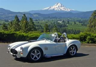

I painted my car with a turbine sprayer. Let me give a few opinions. It's not a matter of hobbyist or pro. The turbine can put out a pro job, but your local paint store and local painters won't be able to help you set it up. The reason is that the turbine sprayers heat the air substantially more than a 80gal air compressor. You pretty much end up using the slowest reducer you can get, without going to an outright retarder. You add as much as you have to in order to get good flow. This is THE major disadvantage of turbines. Once you fight through the frustration and figure out your mix there are some serious advantages!
Turbines put out a consistent PSI all day long. No worrying about whether your air compressor can keep up. We don't have enough power out in our shop to easily run a 220v 80gal compressor. The turbine however works great. Also, you can get them in 3 or 4 stage turbines. Just get the 4. Anything less just doesn't cut it if you are trying to paint a good finish like a car.
If you go with a system like the Axis 4 stage:
https://secure.foxvalley.net/axispro...yer/Respirator
You get a secondary turbine built in that runs your fresh air hoods. You can put two people on one of these. You MUST use supplied air when shooting todays paints unless you don't like your health. All skin should be reasonably covered. A cheap tyvek suit and supplied fresh air hood is a good idea.
I bought my unit several years ago, but www.autobodystore.com had about the best price at the time, and I was able to order everything there. Very helpful people.
My final opinion: They work very well and we are going to use ours to paint an aircraft soon and then eventually paint my car again (car will have 6 years of rock chips on it by then), but if you can easily power and store an 80gal 220v compressor, just do that instead. You can get more help on reducers from your local painters by using common equipment.
I'd like to see more people use these. They really do work, there just isn't much support from the painting community.
Good luck!
Edit - pic:
