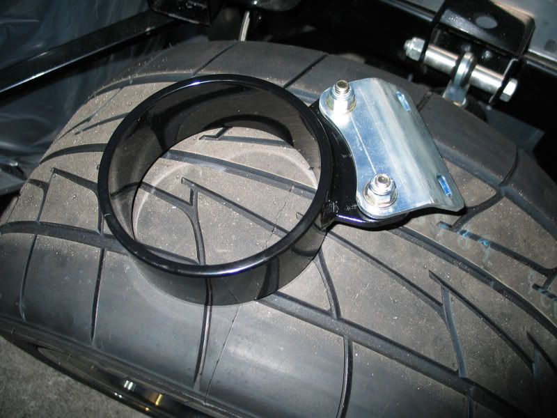

I mentioned this product several months ago in another post. I finally picked one up, and though my driveshaft isn't here yet, a quick visual install looks like there will be no problem clearing the shaft.
This is a Mustang/Cougar safety loop from Total Control Products. The page for the product is HERE.

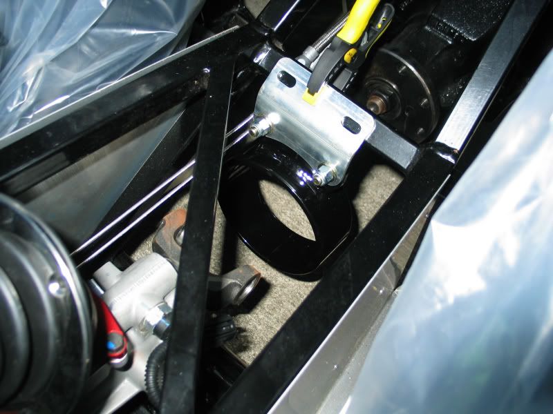

All I had to do was take the frame bracket (this usually bolts to their Mustang subframe connectors) and "unbend" the 90-degree bracket back to a 45-degree. My neighbor has a hydraulic brake at his shop and did it for me.
As you can see in these pictures the loop is adjustable vertically (about half an inch) and comes with the mounting hardware. You will have to get longer bolts if you decide to bolt it to the horizontal 1-inch brace. Welding the angled bracket to the frame is also a possibility.
I think this is a real clean solution and keeps the mounting up high above the four-inch main frame tubes.
Hope this helps someone. I'll post pics once the driveshaft is in...

Mark, do you have and IRS rear? Just wondering if you'll have enought verticle room with a solid rear....
Looks nice anyway, perhaps I could take my oval hoop and weld a similar fitting at the top? something to tinker with one day... My summit hoop is still in the box...

It is a 3-link...
Right now the rear is a bit high for ride height (photo with car on the ground)...
Once I get the driveshaft in and ride height set I'll cycle the suspension and make sure there's no concern of the shaft rubbing the loop at full droop (which I don't think there will be)...
Also remember the shaft will move the most at the differential end, not the trans end...

I was concerned with the suspension travel as well, just out of curiosity, whats the diameter of the loop?

According to their data sheet on the web site the loop is 5 1/5-inch ID x 2-inch wide x 1/4-inch thick with grade 8 mounting hardware.
It is mild steel "to allow distortion of loop without breakage" the sheet says...
The mounting tab and bracket are 1/4-inch thick as well...
Adjustment slots allow for 1/2-inch vertical and 3/8-inch horizontal adjustment (from mounted position)...
The loop is powder coated and the bracket is zinc coated...
HTH...

This is the kind of item we could make ourselves -- possibly even a bit larger - 6" diameter? If room becomes an issue.
I am a litle leery of bolting it the the frame brace where you have it sitting in your pictures....0.050" wall 3/4x3/4 isn't exactly the strongest metal to be bolting/welding to...

That is a nice solution. Unfortunately, it would be a nightmare to retro fit. Goes into the category of things I should have done during the build...

I don't know Jesse. The aluminum right over that brace I don't think touches. You could drill from underneath, run the bolts UP and into nuts welded to the bracket. Worst case, you drill through the aluminum and the brace and you would have two bolt heads at the rear of the cockpit where the tunnel meats the rear wall. Cover them with a small bit of carpet or just paint the bolt heads black?
Where there's a will, there's a way!
As soon as I get my driveshaft from Mike Forte I will take more pics and report on this...

If you look at the design, the hoop unbolts from the bracket. So even if you weld the bracket in, or bolt it in so that you can't access the bolts with the interior in place you can still unbolt the hoop from the bracket and remove it with the driveshaft together.
