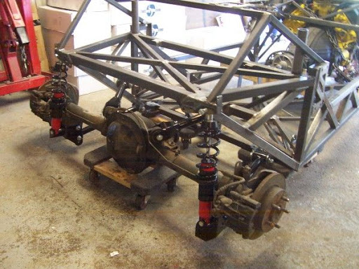

Originally Posted by 68GT500MAN View Post
Brett,
When you say that the passanger side upper control arm does not fit, what are you refering to?
When you install the upr control arm onto the body of the car. I can get one bolt in (front or back) but once one is in, the other one is so out of alignment that the bolt wont even start into the hole. I can pry it with a big screwdriver and pulling as hard as i can, get the hole to align but even then the back end of the hole is not lined up. As soon as i release pulling on the screwdriver, it goes back to the original misalignment. I should be receiving the second control arm from FF5 today or tomorrow.
Brett

I think he means the shocks should be mounted straight up and down. There should be another set of mounting holes on the outside of the frame, the eye of the shock goes up inside the "pocket"

Originally Posted by towman View Post
im not sure but i thank you got your upper coilovers mounted in the wrong spot you should dubble check that can someone elese comform that they go this way
You are right. I am not at home to check physically, but all the photos i see that the shock is almost vertical where mine are at a pretty big angle. Thanks so much for catching that.
Brett

FWIW, I'm building #227, and I just cut off the ends of the lower control arms, and the outer tie rod ends also. Took .5" off each piece. I was able to get just about all the caster out of the front end. If I can remember, I'll take a measurement tomorrow on my lower arms to see what they measure. I do remember it was a pain in the butt to get the front arms into place. I have a 2lb. urethane dead blow hammer that I'm sure I used on them. Seems I remember taking a regular 2.5# cross pein to a couple of the mount ears on the frame too, because I was thinking to myself... as much as they check these things before they leave the plant, you would think chit like this would be fitting when you got it...

I got the new upr control arm from FF5 and it fits! What a relief. I was able to build the drivers side while the new passenger side is off to PC. While doing that i noticed that the drive shaft coming out the differential is off from center of the car by about and inch?? See photo below. Is that normal for an 8.8 rear end? I dont recall seeing that at the build school. Somebody tell me I dont have a biggg problem here.

i hate to be the one to tell you this but i think you got your front coilovers on upside down i know they look right but they go the other way

... had the samed immediate thought about the direction of the coil overs. I had mine upside down myself, as this look right to me. But the manual says different.

The fronts are installed upside down so you can get to the spring adjuster rings.

Thanks guys. Man, these shocks are killing me. I guess i need to pay more attention to the manual as opposed to what looks right.

3 washers
clearance with 3 washers
Now I am taking the drive shaft back out to paint it to match the rear end. The paint on it from FF5 is crap. It is already starting to rust in some areas.
