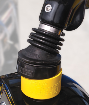

Yes, I had to buy a different radiator hose from Pep Boys and cut it to make the filler cap work for the outside. Put a steel tube in the middle to connect the upper half that comes with the kit to the lower half from the radiator hose.
The gas still backs up in the tube a bit so I have to hold the nozzle just outside the hole and shoot it in. I think I'm going to get a McCuff for filling. Hey, Paul Senior uses it and he's a man of integrity ( I mean, how many people have the balls to sue and disown their own kids!) And yes, I used the cap that came with the kit. It works great. I'm actually using the stock tank and so far, no real issues! Just remember to throw out that square seal for the sender and get a round one!
McCuff
Hi Erik,
I just received my TOP and have been going to the various inspections to get registration I filled my tank at a gas station the other day and it spit back somewhat and got gas on top of the body. I had to hold the nozzle just at the top of the hole and dribble the gas in. It took 10 minutes to put in 8 gallons of gas I relocated my fill cap to the top of the car as you did. Did you get the McCuff and did it eliminate the backup of gas in the tube?
Thanks for your comments.
HR #246
